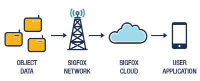

Architecture
A SigFox network consists of 3 typical components:
  • SigFox Ready Devices
  • SigFox Base Stations
  • SigFox Cloud

SigFox Base Stations: SigFox base stations are deployed and operated by SigFox operators or by SigFox itself throughout the world. They act as an intermediate between the Sigfox devices and the SigFox Cloud. The base stations are connected to the Cloud by using point-to-point links and are protected. They are responsible for demodulation and checking the messages, and then pass it to the Cloud.
SigFox Cloud: The SigFox Cloud comes with three interfaces: web UI for the end user, API to integrate third-party services, and callbacks interface to push messages to third-party servers. Constant checking for data by the user application to the Cloud is not required due to the callback interface implementation. The SigFox Cloud also acts as one point to manage the complete network. It allows the user to register new devices, manage users, and manage APIs and Callbacks. The SigFox Cloud comes with a recurring cost for the user.
How SigFox Communication Works?
SigFox Ready devices act as end nodes and transmit data to the SigFox Cloud through base stations.
The nodes transmit messages and are received by nearby base stations providing space diversity. The devices are not attached to specific base stations. The SigFox Cloud checks the authenticity of the message and action associated with the message. It also removes duplicate messages sent by all the base-stations who received the same message. Then the Cloud reports the collected data to consumers or partners, who can have their own IT infrastructure.
