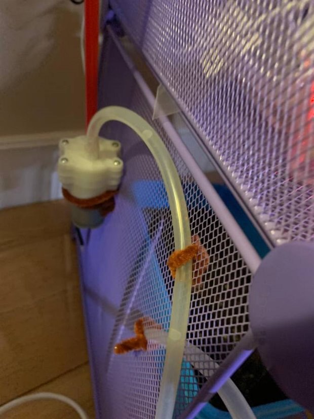

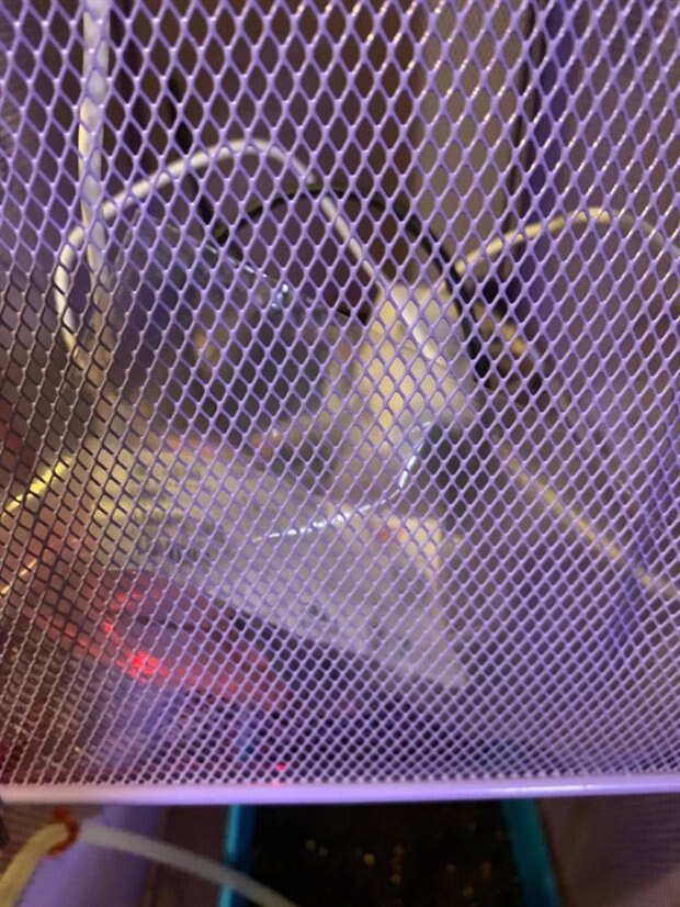

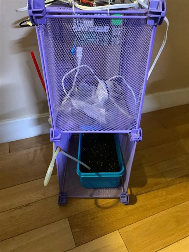

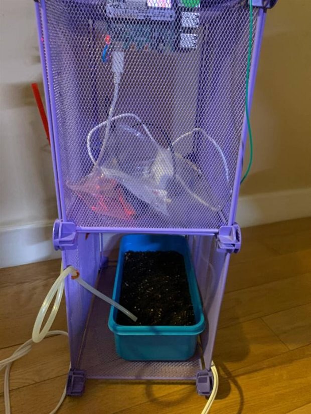

Almost done with assembly!
Here:
Front view, powered off.
Power structure:
There are two 110V AC plugs required. One is a cable extender to power pi and arduino, and one for the pump.
I figured it might be a good idea for manual power cut to the pump.
As you can see on one of the later images, the Pi is booted with the python script running.
