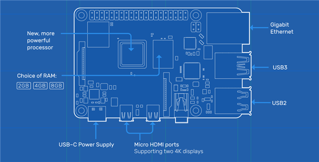

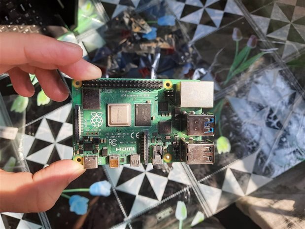

Raspberry Pi 4(2GB version)
There are already countless sources of information on getting to know the Raspberry Pi 4 on the internet. However, for sake of completion, I will cover that here.
The Raspberry Pi 4 is a single board computer for hobbyists and makers to quickly get to stead with using Linux for building embedded and IoT applications. It has a strong community base and is the established standard for Linux-based hardware in the electronics world. It is really easy-to use and offers enough computational power to do complex tasks like image processing. It has a multitude of interfaces like GPIO, display and audio ports along with Wifi and Bluetooth through which it can physically interact with almost every entity in the world of IoT.

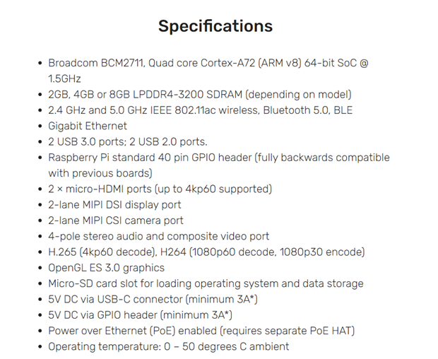

If you want to know more you can find the entire list of specificitations here:
As can be seen clearly from the spec sheet it packs in lots of features into a board of this size. I am sure you are really excited to use it. I won`t reinvent the wheel here and would suggest you to go ahead and log on to
https://projects.raspberrypi.org/en/projects/raspberry-pi-getting-started to know more and get started

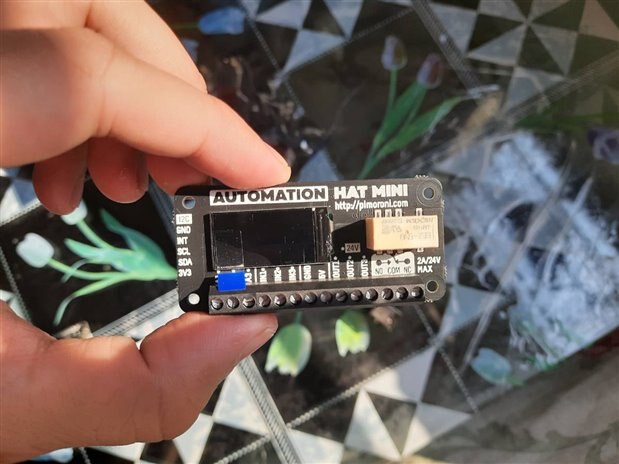

Pimorini Automation Hat
The Automation hat allows us to interface external devices operated at up to 24V to the Raspberry Pi

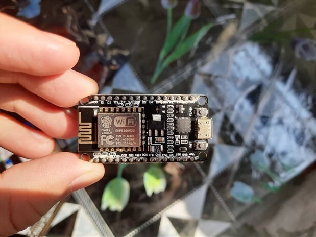

NodeMCU

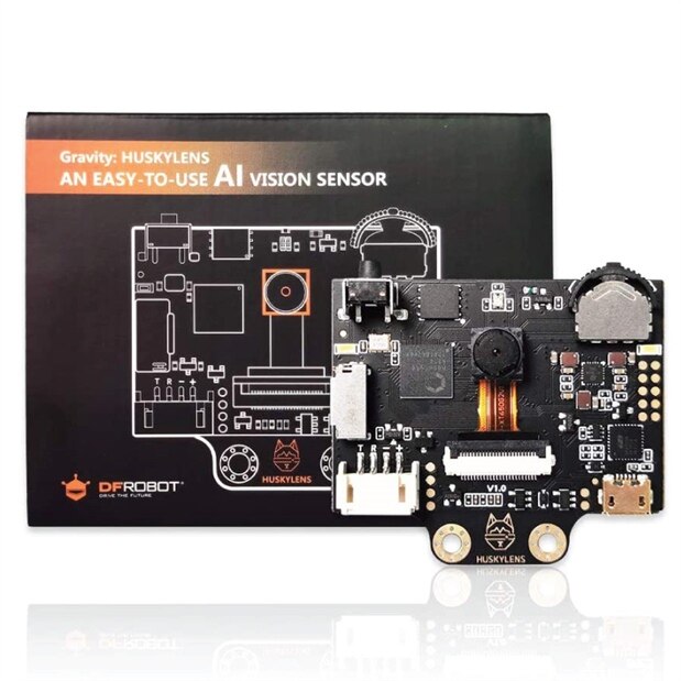

Husky Lens
