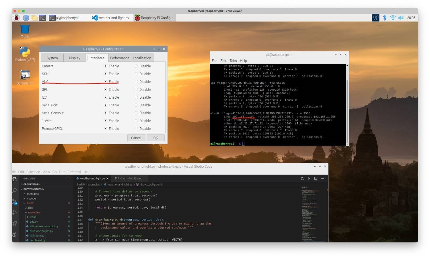

VNC Server
As the Raspberry Pi setup is placed in my garage, I set up a VNC server on Raspberry Pi for remote access.
This is very straightforward thanks to Raspberry Pi Configuration. All we need to do are check VNC "Enabled" box and find out the IP address of this device. From my main computer, I installed a VNC viewer and established a connection to the raspberry pi using the same Wifi access.

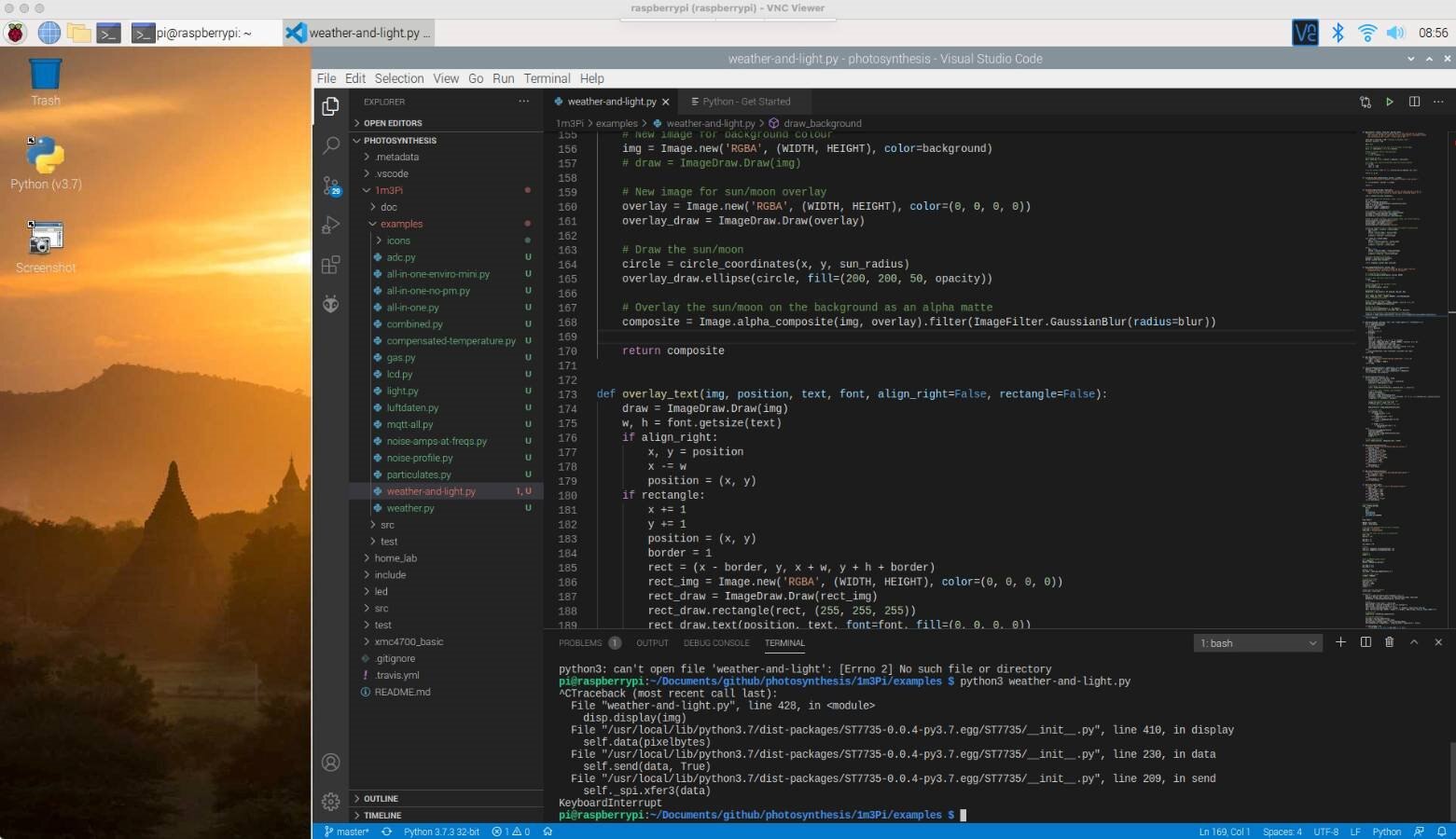

Visual Studio Code
Raspberry Pi comes with Geany and Thonny as pre-installed software IDEs. We can also use a terminal or text editor to write codes and run codes from python console/terminal.
I was originally bit worried about how well Microsoft's Visual Studio Code would run on Raspberry Pi. It actually runs more smoothly than Arduino IDE so far.
The instruction in this link (https://pimylifeup.com/raspberry-pi-visual-studio-code/) was very useful.

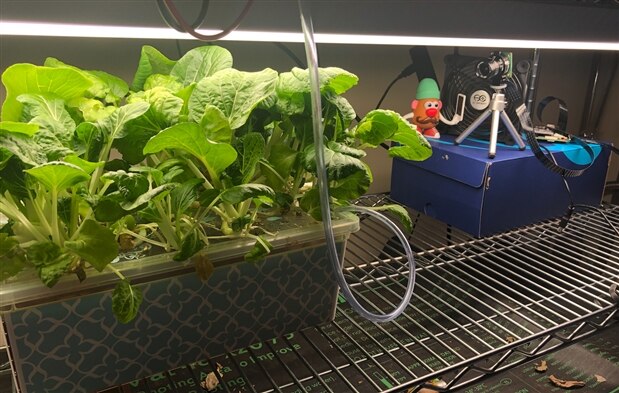

2. Add a camera to check the microgravity garden remotely
By connecting a raspberry Pi camera, we can see vegetables
A command below from Terminal can do a live capture from the raspberry Pi camera
raspistill -t 0

  • skruglewicz
    skruglewicz over 5 years ago in reply to kurama007
    I started using it use it on the PC if you get on the 32 bit ARM PI
    DAB over 5 years ago in reply to kurama007
    Just remember, tomatoes and peppers are both heavy feeders.
    If you give them that much light, they are going to be very hungry.
  • kurama007
    kurama007 over 5 years ago in reply to skruglewicz
    Yes, VS Code has been very good for me and Raspberry Pi Operating system.
    Satoshi
  • kurama007
    kurama007 over 5 years ago in reply to DAB
    Hi DAB,
    I have set up a smart power outlet to turn on the light for 16 hours per day. This turned out to be good amount of light per day for leafy vegetables at medium level light intensity. For tomato and peppers, they needed brighter light to grow bigger image
    Good start.
    The plants are doing well.
    How much light are you giving them each day?
