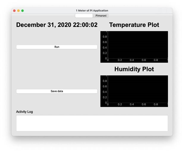

I usually would like to start a rough concept design before implementations. The GUI is built with PyQt5, which is a python package used for GUI frameworks.
Prototype Design
So far, 1 Meter of Pi Application is being developed on Mac OS.  I am using PyQt5 as the GUI framework. PyQt has many good features. I finished the initial layout design and the snapshot is here!
The GUI shows real time information. It will have a few features like
1. take measurements and save the data into a text file for data analysis.
2. Display live data over time
     2.1 Temperature
     2.2 Humidity
3. Show activity logs
     3.1 Show useful log data

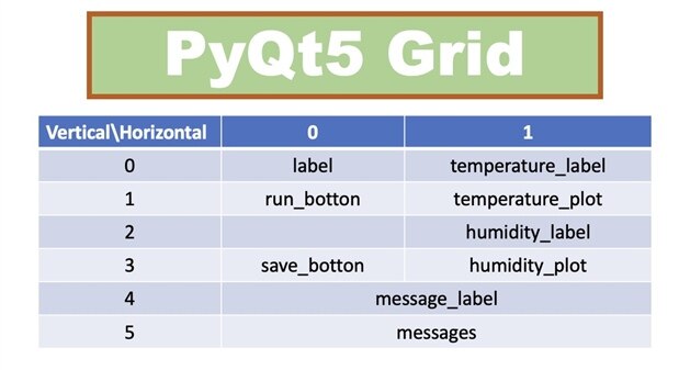

Using PyQt5 grid system, the GUI content is added by the addWidget function.

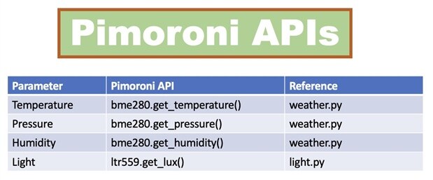

Next, I would like to display the data from the Pimoroni enviro module.
The Pimoroni can measure a few environmental conditions. Here is a list of parameters to be implemented next time!
