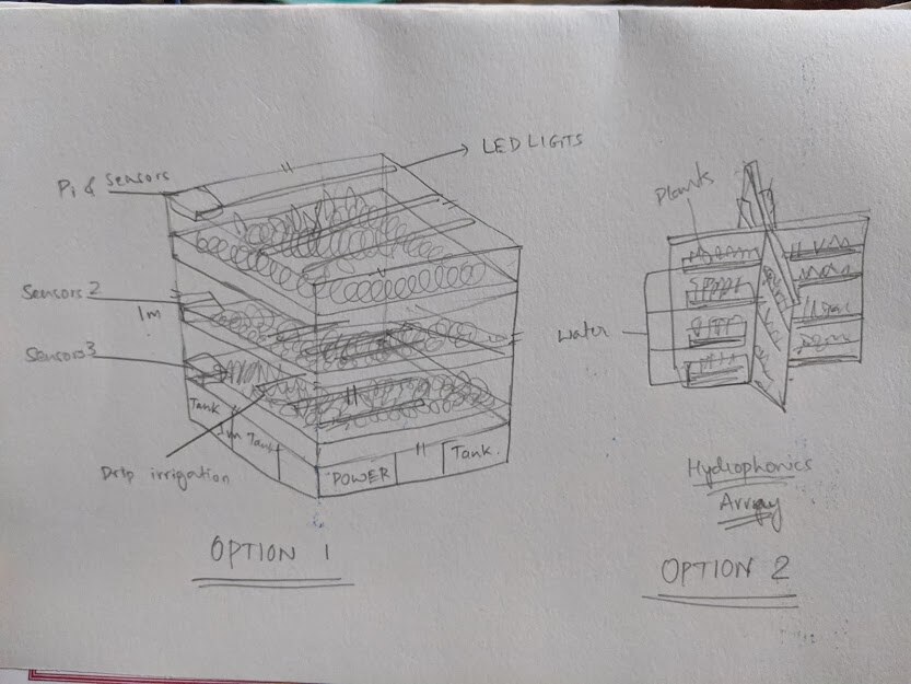

  Keeping in mind all these constraints I would love to design and work on something which can solve the future problem of growing plants in a constrained environment.
The major hurdles for this are
1. Light: Inadequate amount of sunlight will result in the poor photosynthesis process
2. Air circulation: Plants will need a sufficient amount of air to grow
3. Water: Water is essential for the growth of plants as it helps the plant to take nutrients from the ground
4. Space: There should be adequate space for the plant to grow so that it can acquire the essentials such as air and light
How we are going to solve these hurdles:
1. Light: By artificially illuminating the environment with a controlled LED lighting system we can provide adequate light and even the required spectrum for the particular plant.
2. Air: By supplying external air by using some intelligent air recirculation methodology we can fulfil the requirement of
growing plants
3. Water: Drip irrigation method for supplying water to the plants has been found as a best practice to save water ad provide necessary nutrients to grow.
Another best way to save and recycle water is to use the hydroponics method to grow plants
4. Space: With the help of efficient design practice we can build a method to either use an array-like structure one on top of other or like the vertical hanging garden with hydroponics
These are my simple scribbles about the design

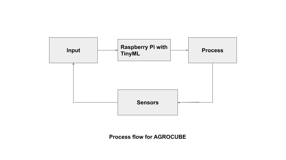

Control:
OK. How do we control this?
The basic control loop we will be using is feedback based closed-loop control system. The advantage here is the use of PiHAT Automation kit PIM487 and  PIM486 sensor units.
The feature which makes it different from the existing control system the use of TinyML to control the water, air and light flow on the plants. With the help of edge impulse,
we will train a model and it will help us to accurately predict the plant's health and act on it. The environmental sensors will help us to accurately measure the data and the display on the shield will help us to show the health and vital information on the screen. The relay in the automation unit will help us to turn on and off the water supply, lights etc. Since the resource is limited it is essential for us to utilise it in a careful and concerned manner.
These are all about my Idea and how I will be utilising the hardware to build something that is useful in future.
    DAB over 6 years ago +1
    I think option 2 is your best bet. DAB
    DAB over 6 years ago in reply to vishwasn +1
    It would depend upon how high your plants get. If you go with Option one, you will need to use smaller plants, but if you want to do the taller plants, then option two. DAB

    vishwasn over 6 years ago in reply to DAB
    Oh. Yeah. Thanks for the suggestion.
    Yes, Option2 looks easy to implement and easy to harvest, but do you think that will be optimum utilisation of space?
