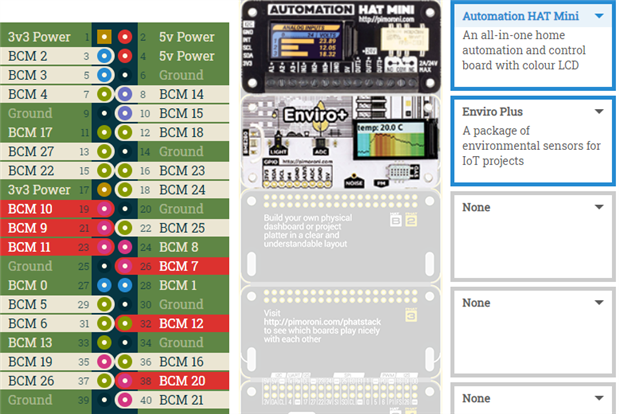

2) Problem
When I found out that two HATs that we got in the challenger kit did not stack I was quite disappointed. Mostly because RPi4 2GB has more than enough computing power (and pins) for much more sensors and controls than those two HATs.
If we go to https://pinout.xyz/phatstack and select Automation Hat Mini and Enviro Plus (there is no option for basic Enviro HAT), we can see the clashing pins
From what we can see here there are 6 pins clashing so there should be no way to use them on single RPi.
But I can't accept it image

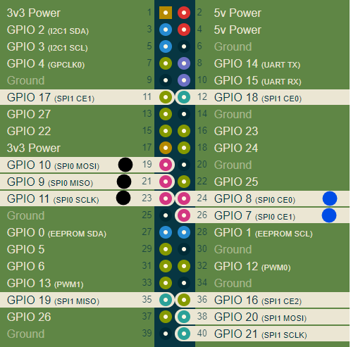

SPI - Serial Peripheral Interface
This is a 4 wire serial bus used to connect multiple devices, 3 wires are common and 1 wire (CS-Chip Select) is separate for each device.
On RPi there are 2 SPI busses:
  • SPI0: GPIO 7, 8 as CS pins and 9, 10, 11 as common pins
  • SPI1: GPIO 16, 17, 18 as CS pins and 19, 20, 21 as common pins
Our two HATs use SPI0 bus for ST7735 LCD display. They use common GPIO 9, 10,11 (marked black) and these are safe to share between both displays
But they also both use same CS pin GPIO 7, and we have two CS pins available on SPI0 (GPIO 7 and 8) so one of them should be switched to GPIO 8.

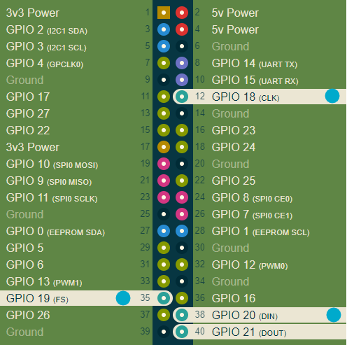

I2S/PCM - Pulse-code Modulation
Used for digital audio input or output, uses 4 GPIO pins
  • GPIO 18 - Serial Clock
  • GPIO 19 - Word select
  • GPIO 20 - Serial Data In
  • GPIO 21 - Serial Data Out
Enviro HAT uses pins GPIO 18, 19, 20 (marked with blue dot) for MEMS microphone

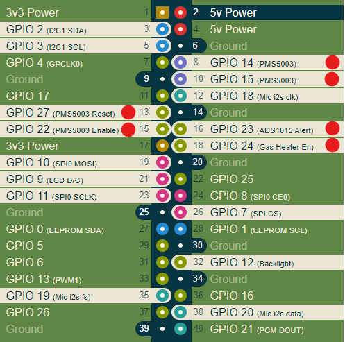

Enviro
This is the pinout of Enviro Hat:
Pins marked with red dot are not connected on Enviro, and are only used on Enviro+ so we don't have to take them into consideration
  • ST7735 (display) - GPIO 7, 8, 9, 10, 11, 12
  • BME280 - I2C: GPIO 2, 3
  • LTR-559 - I2C: GPIO 2, 3
  • MEMS microphone - I2S: GPIO 18, 19, 20

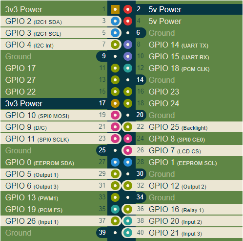

Automation HAT Mini
This is the pinout of Automation HAT Mini:
Thing to note here is that this HAT takes the 3V3 Power from pin 17
  • ST7735 (display) - GPIO 7, 8, 9, 10, 11, 25
  • ADS1015 (Analog channels)- I2C: GPIO 2, 3, 4 (not sure what is GPIO 4 about, still trying to get answers)
  • 3 Inputs - GPIO 26, 20, 21
  • 3 Outputs - GPIO 5, 12, 3
  • 1 Relay - GPIO 16
Clashing pins
As a result of research these are the only clashing pins:
GPIOEnviroAutomation HAT Mini
7SPI CSSPI CS
12Display BacklightOutput 2
20I2S Serial Data In (microphone)Input 2

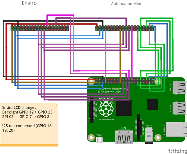

4) Solution
I would like to keep the Automation HAT Mini unchanged so official automationhat library can be used, so only changes are going to be made to enviro pinout
Enviro GPIO 7
This is one of a SPI0 bus CS pins (we have two available), so we will move it on Enviro to other available CS pin GPIO 8. On Automation HAT Mini it will stay the same.
Important thing here is to change that pin in the Enviro example code (ST7735 initalization).
Enviro GPIO 12
This one is used on Automation HAT mini as an Output 2 pin, and on the Enviro for display backlight.
On Enviro I will switch that pin to GPIO 25, it's the same pin Automation HAT Mini is using for backlight (it can be shared)
I am going to use both displays together, so if you want to change backlight individually I suggest you put it on some other empty pin (eg pin GPIO 13)
Also don't forget to change backlight pin in the example code (ST7735 initalization).

5) Auto-Enviro HAT
So this new "Auto Enviro HAT" will be the combination of Enviro, Automation HAT Mini and Pico HAT Hacker.
Requirement is to be able to quickly connect/disconnect modules for replacement or inspection.
Idea is to use Pico HAT Hacker with one 40pin female header to plug into RPi, and two other 40 pin male headers, one connected to Enviro and the second to Automation HAT Mini.
male headers would be connected with wires to Pico HAT Hacker so they can be positioned away from RPi heat (messes with temperature readings)
Wiring schematics
