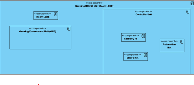

Growing Housing Unit (GH)
As I mentioned, to grow Spirulina Algae successfully,  an ideal environment of Water, Temperature ,CO2 and Light must be monitored and maintained during the growing process. To accomplish this, a Growing Housing (GH) will contain a growing environment unit (GEU) and up to 2 Controller Units (CU) to maintain Water, Temperature,,CO2,PH and Light Exposure of both the GH and the GEU environment.
Here is the component breakdown within the Growing House
  • Growing Housing Unit GH
    • This is the housing that contains a:
      • spirulina growing tank
      • instruments to aid in the growing process
      • Raspberry PI controller to control these instruments.

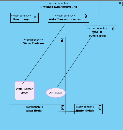

        • Growing Environmental (GEU)
          • This is the environment the contains the growing Spirulina in a tank of water.
          • attached to the growing tank are the following Instruments:
            • A light Source outside the water of the tank
            • A Heater in the water of the tank.
            • A Pump outside the tank that pumps air down a flexible hose, that is placed in the water for aeration.
            • A Water Temperature Probe to monitor the temperature of the water.

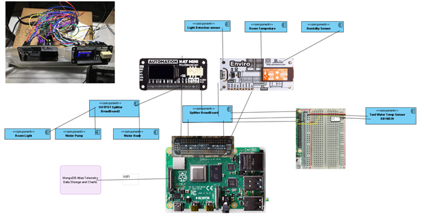

        • Controller Unit  Raspberry PI
          • PM487 Automation Hat
            • This controller will control the instruments used on the GEU.
            • It will be programed to manage and monitor the instruments attached to the GEU
          • PM486 Enviro Hat
            • This controller will control the instruments used to maintained and manage the environment within the GH
            • It will be programed to manage and monitor instruments in the GH.
  • The following diagram describes this relationship.
  • The Growing Housing Unit will be one quarter of the space of 1m Cubed required by the Design Challenge.
Growing Environmental Unit -- GEU --- What's Inside.
Controller Unit (CU)
GEU instruments controlled by the CU
  • Temperature of the water
    • between 8C (46.4F) AND  45C (113F)
    • studies have found that the ideal temperature is 35C (95F)
  • Oxidization in the water (Mixing)
    • Turn On the  AIR Pump
    • 1 minute 3 times a day
  • Amount of light exposure
    • Studies show to improve the growth rate:
    • a light can be turned ON every hour for 45 minutes and OFF fo r15 minutes
    • From 7am to 10pm
  • Alerts
    • send out alerts if certain components of the GEU  are out of operation range, malfunctioning, etc.
    • Send the alert in an email to the system operator.
    • Example: The temperature of the water is out of range.
      • Others?

GH instruments controlled by the Automation HAT
  • Water Pump Switch
  • Light Switch
  • Heater Switch
GH Environment elements controlled by the  Enviro HAT
  • Humidity
  • Temperature
  • Check Room Light

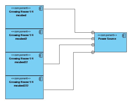

4 Growing Housings = 1 Meter Cubed space
  • There will be 4 growing housing units a quarter of a cubic meter in volume
  • With four GH units with 20 gallon tanks in each one, that will equal a total of 80 gallons of water in the system.
  • The GH units can be stacked as described below or positioned side by side.
  • The combination of these quarter cubes will make up the cubic meter required by the challenge.
