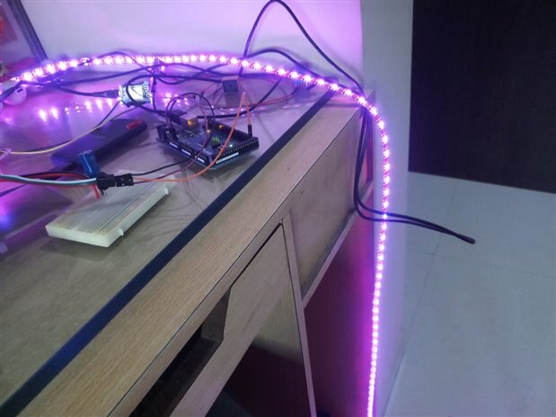

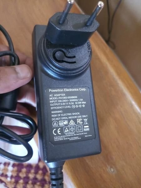

As I am going to use RGB LED strips to provide proper lights to my plants, I have started to do experiments with the
strips I have. The LED strip is 2m long with 60Leds/m. Each LED consumes approx ~60 mAmps. This means the entire
strip would need approximately 7.2 Amps. The Led strip needs a standard 5V supply. So the adapter like the one in the
below picture should work to supply the required Watts to the strip.

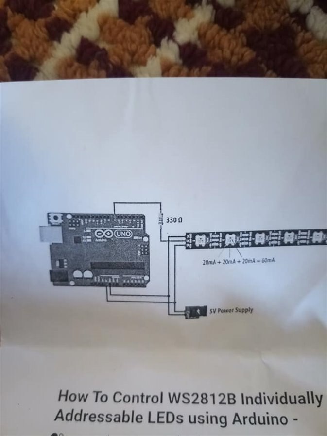

Now, the RGB Led's have +(plus) and -(minus) as well as DIN pin to send the RGB color data.
Hence one needs to connect the DIN pin to the controller which will send the RGB data.
I am using Arduino to control the RGB strip. Normally the strips are connected with the Arduino
as shown in the below picture. The ground pins from the Arduino and the LED strips Both needs
to be connected. The DIN pin requires small Resistance to avoid any disturbance on the DIN line.

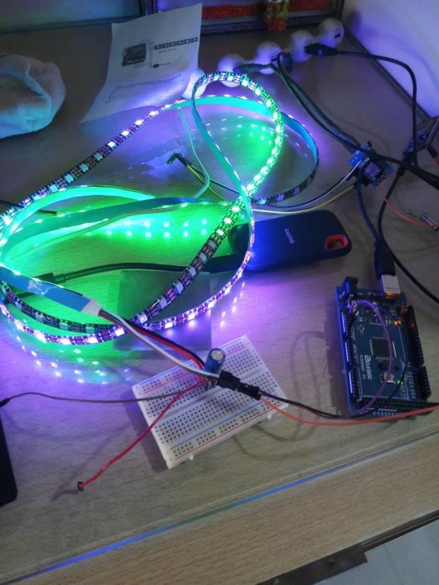

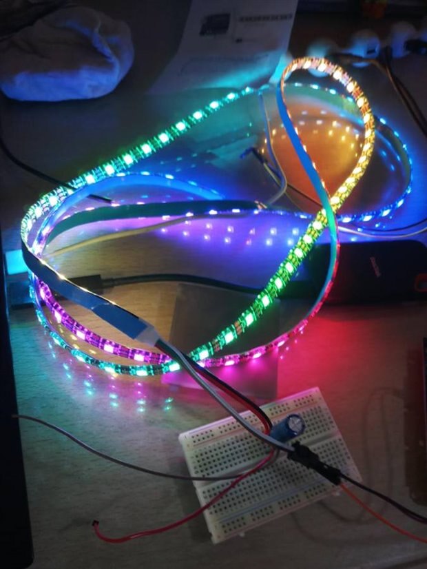

After a while, you would see that the LED strip is entirely blinking starting from the first to the last LED.
You might notice that the RGB calibration is not good.! There is wrong color blinking from the LED!!
To calibrate that you may want to upload the Calibration program from the Examples directory.
You can then set the right RGB sequence in the above loop() function.
For example, after uploading the calibration program if there is 1 Blue 2 Red, and 3 Green LEDs blinking then
the right setting should be BRG.!!
