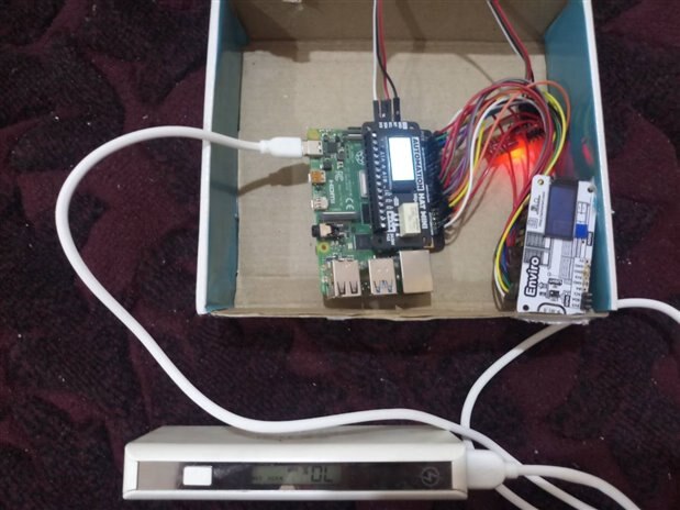

There are currently the following parts of the project.
  1. Raspberry Pi 4B
  2. Pimoroni Automation HaT
  3. Pimoroni Enviro HaT
  4. DPS310 Sensor
  5. ESP8266 + BME280 (MQTT Publishing)
  6. WemosD1R1 + BME280 (MQTT Publishing)
  7. Esp32 Pico V4 + RGB LED Strip (MQTT Subscribing)

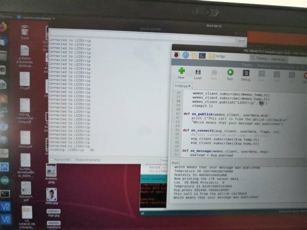

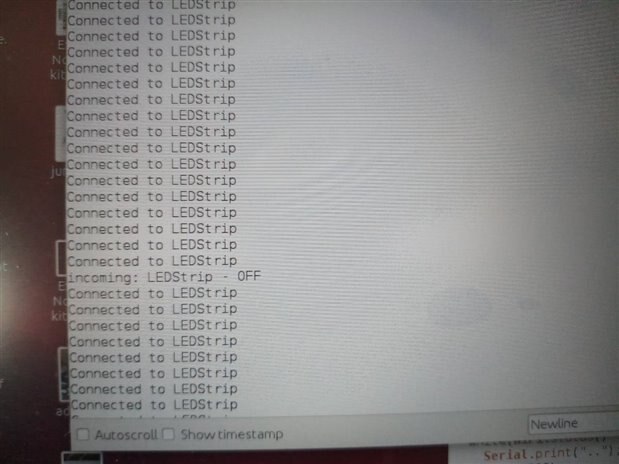

Let me first explain what the project is doing. The RaspberryPi is controlling everything. There are sensors on Enviro-Hat and ESP's sending data over
MQTT and Automation Hat's LCD is used to display the data of the sensors.

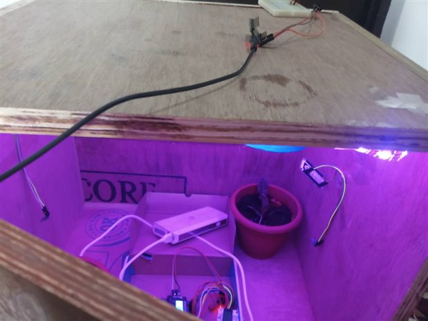

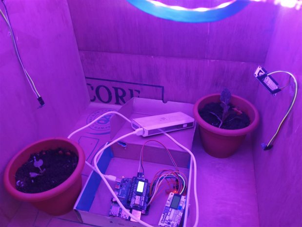

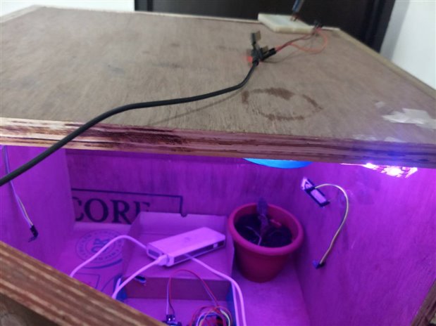

I have kept publishing and subscribing ESPs separately. In the beginning, I wanted to use ESP8266 for subscribing + publishing the topics but I found some
issues are there with the libraries to do both subscription and publishing at the same time on ESPs. Hence, I decided to only do a subscription for controlling
LED Strips. The LED Strips are controlled in brightness. When an "ON" message is published on a topic by Raspberry Pi LED Strip will start with Lower brightness
and eventually, it will reach full brightness. It will take around 15 mins to blick the entire strip to full brightness.
The color of the strip is normally kept magenta pink as that is the wavelength required by the plants growing in space.

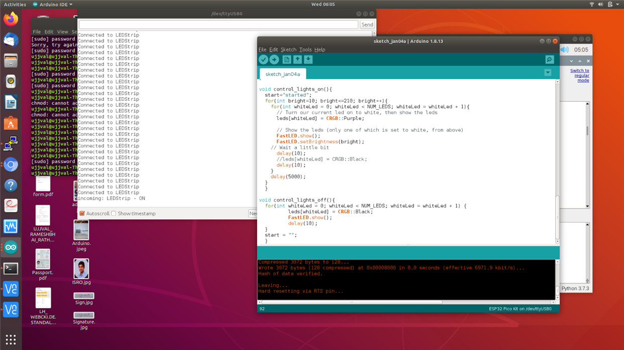

The following code is for controlling the LED strips over MQTT. There are two separate functions to Turn ON/OFF the strip. The topic is published by RaspberryPi.
The ESP32 will subscribe to that topic.

//ESP32 Pico code
#include <SPI.h>
#include <MQTT.h>
#include "WiFi.h"
#include <FastLED.h>
#define NUM_LEDS 120
#define DATA_PIN 15
String start = "";
CRGB leds[NUM_LEDS];
const char *ssid = "PiFi";
const char *Pass = "PSK";
const char *Lighttopic = "LEDStrip";
const char *mqtt_username = "ujjval";
const char *mqtt_pass = "PSK";
const char *client_ID = "IDOFCLIENT";
const char* mqtt_server = "192.168.43.71";
WiFiClient WiFiclient;
MQTTClient cl1;
void messageReceived(String &topic, String &payload){
  Serial.println("incoming: " + topic + " - " + payload);
  if(payload=="ON" & start!="started"){
    control_lights_on();
  else if(payload=="OFF"){
    control_lights_off();
void setup() {
  // put your setup code here, to run once:
  delay(2000);
  FastLED.addLeds<WS2811, DATA_PIN, GRB>(leds, NUM_LEDS);
  FastLED.setBrightness(100);
  Serial.begin(9600);
  Serial.print("Connecting to the WiFi..");
  Serial.print(ssid);
  WiFi.begin(ssid, Pass);
  while(WiFi.status() != WL_CONNECTED){
    Serial.print("..");
    delay(500);
  cl1.begin(mqtt_server, 1883, WiFiclient);
  cl1.onMessage(messageReceived);
  if(!cl1.connect(client_ID, mqtt_username, mqtt_pass, false)){
    Serial.print("..");
    delay(500);
void loop() {
  // put your main code here, to run repeatedly:
  cl1.loop();
  delay(10);
  if(!cl1.connected()){
    cl1.connect(client_ID, mqtt_username, mqtt_pass);
    delay(20);
  Serial.println("Connected to LEDStrip");
  cl1.subscribe("LEDStrip");
  cl1.loop();
  delay(10);
  delay(10);
  //LED Strip programming
   delay(10);
void control_lights_on(){
  start="started";
  for(int bright=10; bright<=150; bright++){
    for(int whiteLed = 0; whiteLed < NUM_LEDS; whiteLed = whiteLed + 1){
      // Turn our current led on to white, then show the leds
      leds[whiteLed] = CRGB::Purple;
      // Show the leds (only one of which is set to white, from above)
      FastLED.show();
      FastLED.setBrightness(bright);
    // Wait a little bit
      delay(10);
      //leds[whiteLed] = CRGB::Black;
      delay(10);
    delay(5000);
void control_lights_off(){
  for(int whiteLed = 0; whiteLed < NUM_LEDS; whiteLed = whiteLed + 1) {
          FastLED.show();
          delay(10);
  start = "";

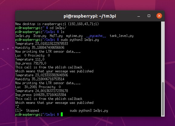

The ESP8266 and Wemos D1R1 with BME280 has almost a similar code running. They will gather the temperature/humidity data from the sensor and publish it on the respective topics.
//ESP8266 code

The Raspberrypi has both the HaT's and programmed in Python to control everything automatically. The LCD on the Automation HaT will display data
from sensors connected over MQTT and data from Enviro as well.
#!/usr/bin/env python3
import os
import sys
import time
import bme280
import smbus2
from ltr559 import LTR559
sys.path.append(os.path.abspath("/home/pi/1m3pi/MqTT.py"))
sys.path.append(os.path.abspath("/home/pi/1m3pi/Disp.py"))
from Disp import *
import paho.mqtt.client as mqtt
import paho.mqtt.subscribe as subscribe
import paho.mqtt.publish as publish
import DPS
from struct import *
from datetime import *
dps310 = DPS.DPS()
ser_add = '192.168.43.71'
Wemos_temp = '/home/top/temperature'
Wemos_humy = '/home/top/humidity'
Esp_temp = 'ESP8266_temp'
Esp_humy = 'ESP8266_humy'
Lighttopic = 'LEDStrip'
mqtt_user =''
mqtt_pass =''
ltr559 = LTR559()
port = 1
address = 0x76
bus = smbus2.SMBus(port)
cal_par = bme280.load_calibration_params(bus, address)
def on_connect(wemos_client, userdata, flags, rc):
    #print('connected with code' + str(rc))
    wemos_client.subscribe((Wemos_temp,0))
    wemos_client.subscribe((Wemos_humy,0))
    wemos_client.publish("LEDStrip","ON")
    sleep(0.5)
def on_publish(wemos_client, userdata,mid):
    print ("This call is from the pblish callback\n"
    "Which means that your message was published")
def on_connect1(esp_client, userdata, flags, rc):
    esp_client.subscribe((Esp_temp,0))
    esp_client.subscribe((Esp_humy,0))
def on_message(wemos_client, userdata, msg):
    payload = msg.payload
    print(msg.topic)
    global wemos_t, wemos_h
    if(msg.topic=='/home/top/temperature'):
        wemos_t = float(msg.payload)
    else:
        wemos_h = float(msg.payload)
    print(float(payload))
