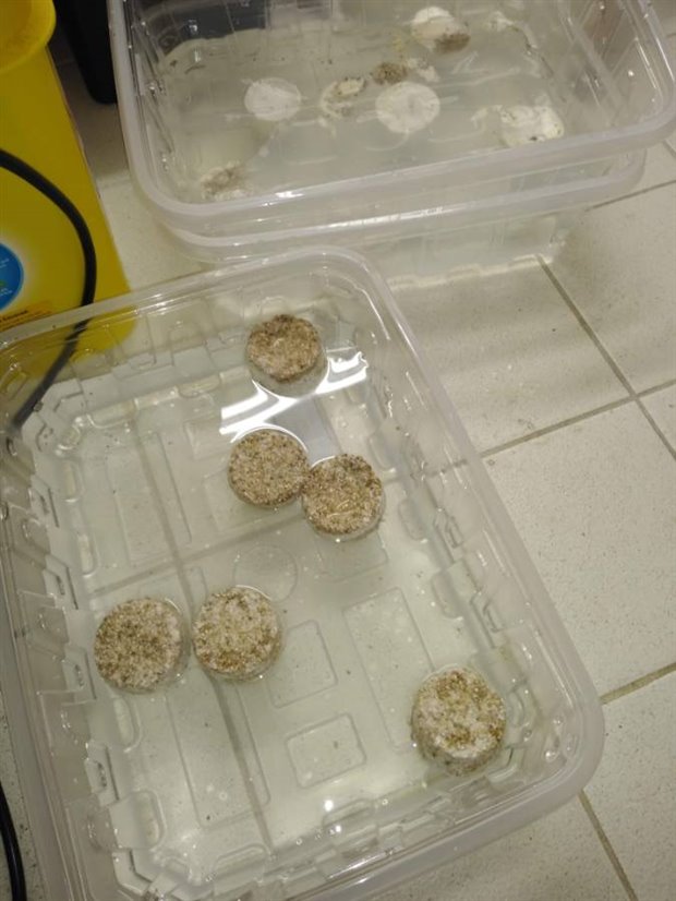

After checking if the cake is fully colonized, I take it out of the jar. I cut it from the jar with a knife.
Cake should be completely white - if there is green, red, etc. colors or bad smell - it means the cake is contaminated by mold and should be thrown away! On the photo above there is a bit of yellow color - it is not mold but rust from the mason jar cap.
Photo of fully colonized mushroom cake. Perfect!
Then I shake not-colonized vermiculite from the cake and put the cake in a container of cold water to rehydrate. They should stay there for 24 hours before they are moved to the growth area. Rehydration helps mushrooms to sprout. It is better if mushrooms cakes are fully submerged in the water, so I put another container filled with water on the top of the container with water and cakes.
Photo of mushrooms cakes in containers with water.

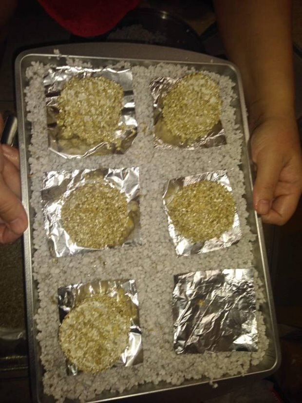

24 hours passed from the end of Step 1, and cakes are ready to go on the trays. In my enclosure mushrooms will be stored on the cookie baking trays. I sterilized the trays and filled them with damp perlite mixture.
Then I cut tin foil pieces, one for each mushroom cake and put them on the top on perlite on the trays, 6 per tray. It is needed to have a protection level between wet perlite and the bottom of the cake. If mushrooms will grow from the bottom of the cake, tin foil will keep the cake clean.
Then I took each cake out of water, scraped it a little bit with a fork, to expose more younger mycelium to the air. It will help for mushrooms pins to form faster.
Photo of scraping the cake.
Then I rolled each cake in vermiculite and put them on the top of the tin foil pieces.
Photo of the tray of the cakes. This tray will go into the enclosure.
I sprayed the cakes from a spray bottle and moved the trays to the enclosure. For my last tray I wanted to use the last 6 cakes of Pearl mushrooms, but because they were not colonized, I used scraps  of all the other cakes. I am just interested if anything will sprout from these.
