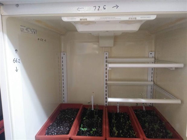

The vegetable part of the garden will be at the bottom of the enclosure, in planters.

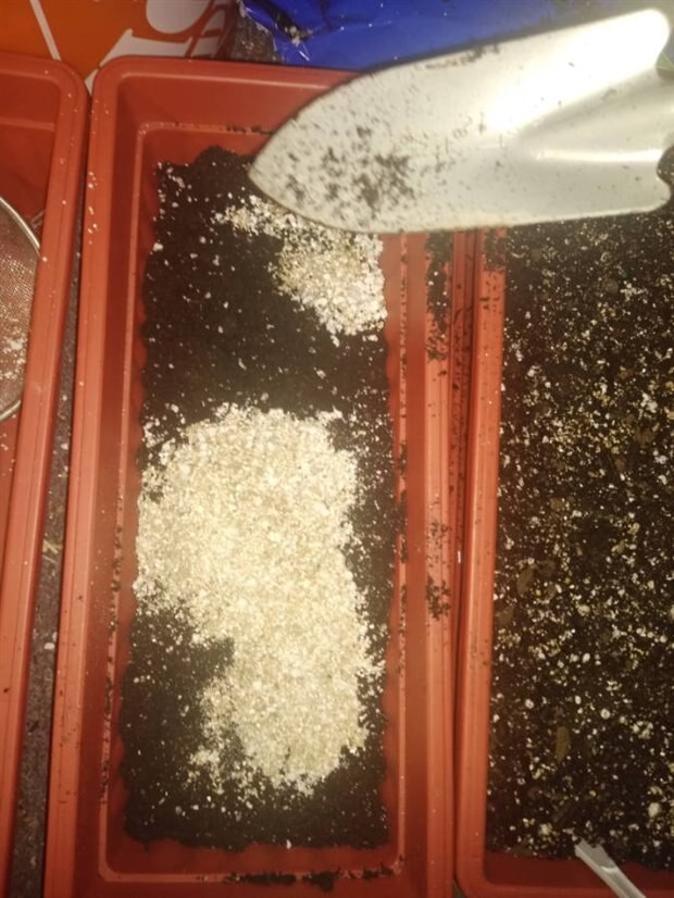

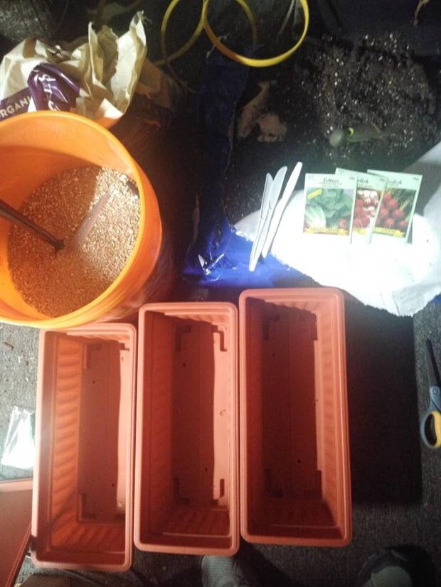

Soil for both of the crops is a mix of 75% potting soil and 25% of vermiculite. I use vermiculite to retain moisture so I don’t need to water crops often.

At the end of the project I will calculate calories and vitamins acquired using growing facts for both. Hopefully it will be sustainable. I have a problem with my enclosure, initially I miscalculated its size and it is too small and it is too late to make a new one. It is 263.17 cm3. So I plan to multiply my harvest yield by 3.8 at the end of the project to get correct data.
Planting was pretty straight forward. Create a mix, fill the planters, put seeds in, cover with a thin level of mix, water it.
Preparing soil mix
Vegetables in the enclosure. 4 planters total.
