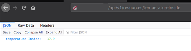

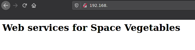

And, just point your browser to it and you should see the following (according to my SpaceVegetablesWebServices.py ):
In the window were the uwsgi test is being made (the same window with all the text above):
[pid: 3237|app: 0|req: 1/1] 127.0.0.1 () {24 vars in 250 bytes} [Fri Nov 13 14:39:45 2020] GET / => generated 42 bytes in 1 msecs (HTTP/1.1 200) 2 headers in 79 bytes (1 switches on core 0)
And your browser
I get the information above. It's working.

And now, try to access your site.
and calling a webservice:

@app.route("/", methods=['GET'])
Flask works by defining routes (decorators) for the URLs requested, either by post or get.
A decorator is used to register a view function for a given URL rule.
So, if someone will request http://<IP_for_RPI4_B>, this is where it will land. We now define a function that will be called.
def home():
    return '<h1>Web services for Space Vegetables</h1>\n'
And will return a web page with a title saying this is Web Services for Space Vegetables, like the following image:
Moving to line 36, we get our first real web service definiton - request the temperatue:
@app.route('/api/v1/resources/temperature', methods=['GET'])
This is register a decorator for the URL http://<IP_for_RPI4_B>/api/v1/resources/temperature .
Remember: We define the URL . It could also be called @app.route('/get/me/some/temperature').  You would put that in the browser and it would just work .  image
If this URL is called, the following function is executed:
def getTemperature():
    return jsonify({'temperature':getDataFromDB('temperature')})
It's going to call our first function, that will query the database for the latest temperature. Since I'm calling the function without the empty variable, it will be the latest available that is not 0.
The jsonify function will transform the value returned (30.5) into json format. The result will be:
  "temperature": 30.5
in json format.
