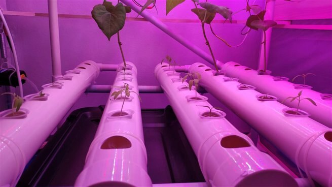

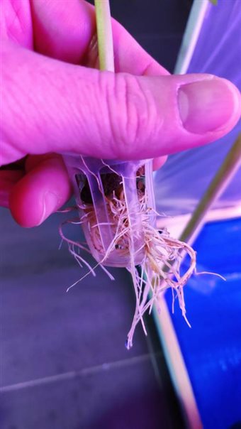

The Vegetables are growing well. The beans - i hope - don't grow any more in height, because they already are reaching into the top hydroponics layer.
I can already distinguish some plants from beans and lettuce. Others I'll need for them to grow a bit more .
According to what I can see, they are growing in good health. The beans roots are looking great.

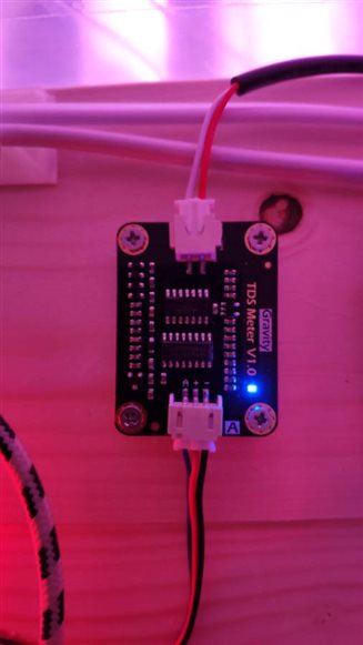

TDS sensor

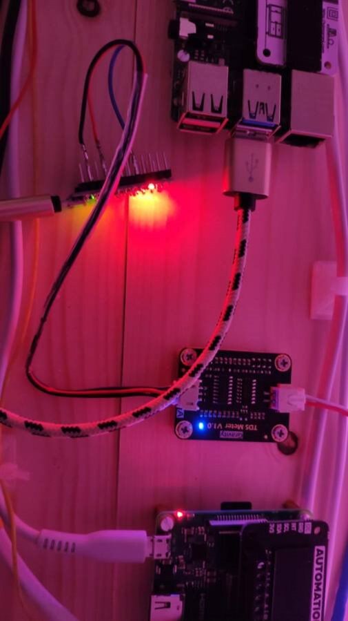

Finally, the TDS sensor has arrived and I can finally start measuring the nutrients quantity in the water.
My initial idea was to connect it to one of the analog inputs off the AutomationHAT mini, but I couldn't make the code work in Python. So, and to not add to much into an already fill system, I connected it to a Arduino Micro Pro and connect the Arduino to one of the USB ports of the RPi 4B - the one with the Enviro HAT. This way, I can power the Arduino, provide power to the sensor and read the TDS sensor values using serial communication.
This will be explained when I post about the Enviro HAT (the Client of Space Vegetables) .

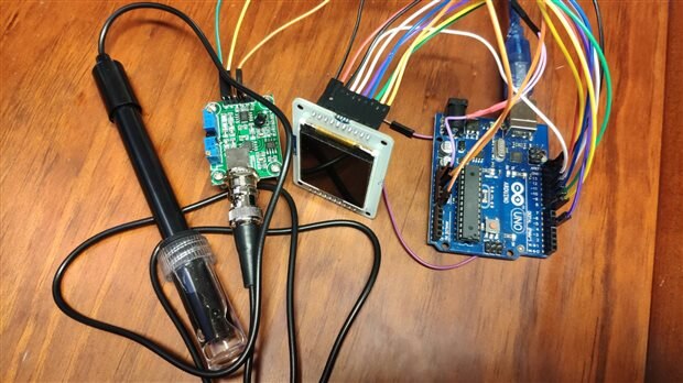

PH sensor
Unlike the TDS sensor, the PH sensor cannot stay in water, so, I can't connect it to the Raspberry PIs. Still, It's already working with a TFT screen attached to it. I will print a case for it and post about it. A portable PH sensor.

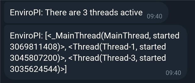

So, to confirm (or not ) my suspicions, the threads in Python have some function to know how many threads are in execution.
I've implemented and scheduled a function to send to Telegram, every 30 minutes how many threads are executing and the names of them.
def checkActiveThreads():
    ac = threading.activeCount()
    log.info ("There are %s threads active", str(ac))
    sendMessageTelegram("There are " + str(ac) + " threads active")
    message = str(threading.enumerate())
    log.info(message)
    sendMessageTelegram (message)

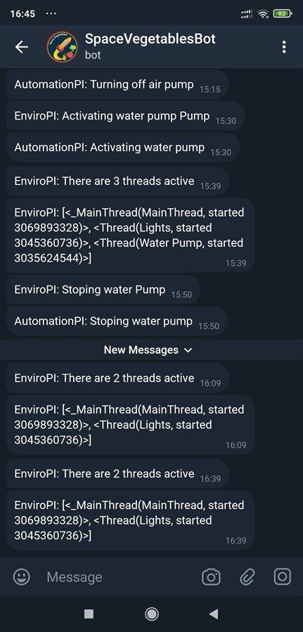

Initially, this was the message of the function:
At 09:40, it should be 3 threads active:
  • Main function
  • Water Pump
  • Lights

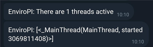

But, 20 minutes later, this was the result:
What was expected ? The Water pump had stopped, like supposed, but the lights thread should be going and it just vanish...
I search in the code and saw nothing unusual. The lights thread was just like all the others (water pump and air pump) and those were working fine. Not for 10 hours, but 15 and 20 minutes... What could it be ?

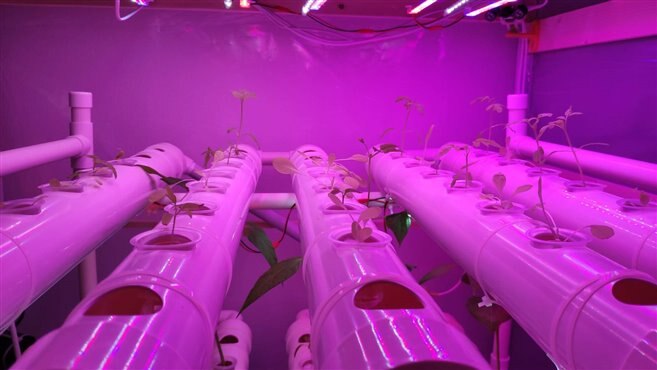

Well, I leave here a new timelapse of the plants growing. This is since week 0.
