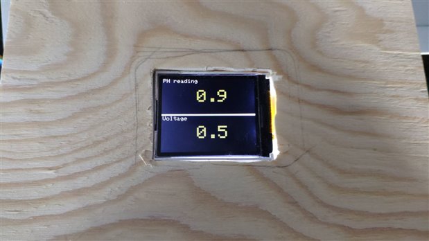

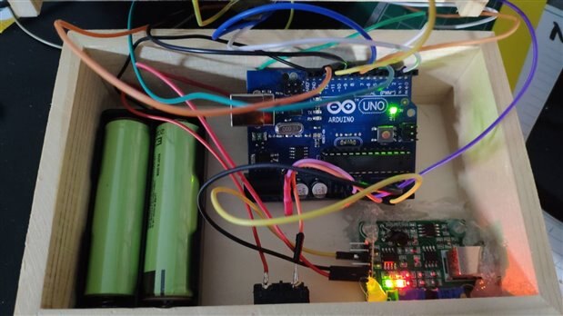

Hi all ! Hope everyone is safe and sound !

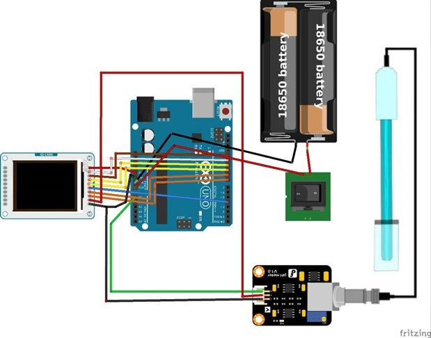

This post is just to share the contraption I made to read the PH level of the water. Because the PH sensor cannot stay in water for long - like the TDS sensor - I've build a small contraption to read the PH level and display it in a TFT screen I had laying around.
Here's the schematics of the build:
The build is nothing fancy - a small wooden box with holes to the power button

To be able to use the PH sensor, it had to be calibrated. Using a PH 7.0 solution just for these purpose, I was able to calibrate it .
Note: The following code is not mine. I've taken it from  https://scidle.com/how-to-use-a-ph-sensor-with-arduino/ . It works very well. In the second listing, I've just altered the code to be used with the TFT screen.
Here's the code used for calibration.

With this, I'm able to use the sensor anytime !
Happy coding.
