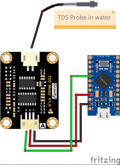

Here's the wiring of the TDS sensor
The Arduino Pro Micro is connected via USB to the Raspberry PI. It provides power to the Arduino and to the sensor and enables serial communication between both to provide the value of the TDS.

Basically, what the code does is takes 30 samples every 40 milliseconds and calculates the average. The result takes into account the temperature .
I use the value as a guideline to make sure there's nutrients in the solution. I'm following the nutrients manufacturer instructions.
