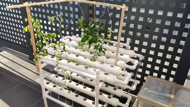

Here's another update on the project. I'm going to keep doing these because the project is still ongoing until I get to eat something grown there ! image
Greenhouse
Because the weather is improving each day (still, a bit of rain is expected) and getting warmer, I've moved the project from my garage to my terrace. No more lightning, but no more automation and no more time lapses. The water pump is now on a timer - 30 minutes every 1h:30m .
Now, it starts to get light from sunrise to sunset and direct sun light from 1:00pm to sundown.No more LEDs.

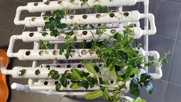

Water
I have to be more vigilant because water evaporation is now more of a concern than before.
Following DAB advice (see previous post) I've move some vegetables to the top layer and already starting to see some improvements. Kudos and thank you

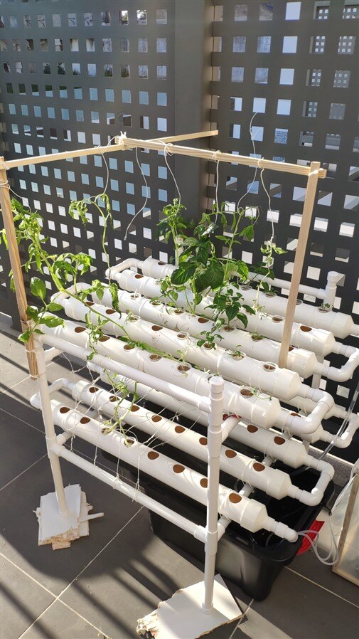

Here are some photos of the new setup:
Because my terrace is not leveled (to allow water to flow) I had to use some cardboard pieces to level the kit, otherwise, water would drain from the tubes when the water pump was active. Found out in the hard way ! image
Here's the final time lapse of the project.

    The plants look a little leggy, you might want to reduce the light exposure time to slow down the growth cycle a little. DAB
