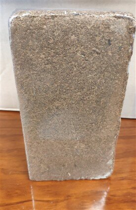

  • Normally, there's no culture medium or substrate. The plant roots are supported by the mesh vase. You can also use some substrate, like lava rocks, expanded clay pebbles or coconut coir.
  • It's an active system.
The image above is a brick of Coconut Coir

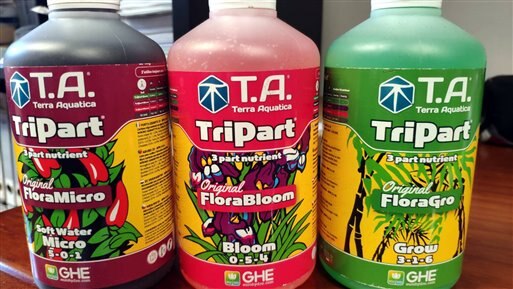

The success and development of your vegetables in hydroponics depends essentially of the nutrient solution. It's from the nutrient solution that the plant gets all the nutrients it needs do develop and grow.
The following image is an example of a nutrient solution to add to the water.

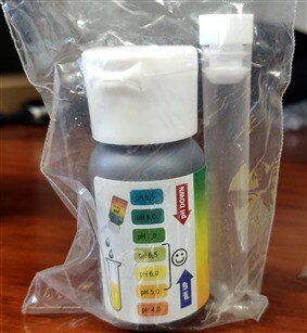

PH
The nutrient solution PH it is very important because plants can't survive in PH values below 3.5. In hydroponics, plants have their development in PH values between 5.2 and 6.5. Within this values the absorption of micro and macro nutrients is best by the plants roots.
The image below is a PH meter - manual. Space Vegetables will use a electronic one.
This is a very basic explanation of hydroponics and what cares should be taken with the system.
