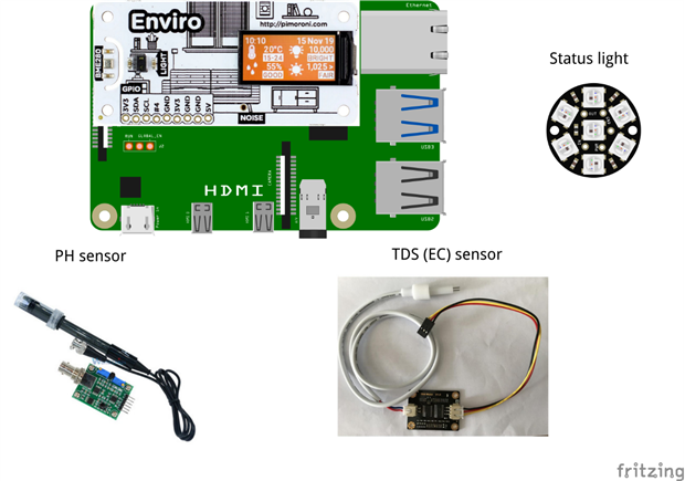

Raspberry PI 4 2GB
This is the more powerful Raspberry PI, so it will be used has the main Raspberry PI , the database server and the Web Services server.
The Enviro HAT will be connected to this Raspberry PI, plus the sensors - PH, TDS (EC) and a status light .
Database Server
To monitor the system status in time and check the values and progress, a SQLITE3 database will be used to store the values.
Values monitored:
  • Temperature
  • Humidity
  • Luminosity (turn on or off the grow lights)
  • Gas sensor
    • Carbon monoxide (CO)
    • Nitrogen monoxide (NO2)
    • Hydrogen (H2)
  • PH
  • TDS (or EC)
  • Pump Active
  • Lights ON

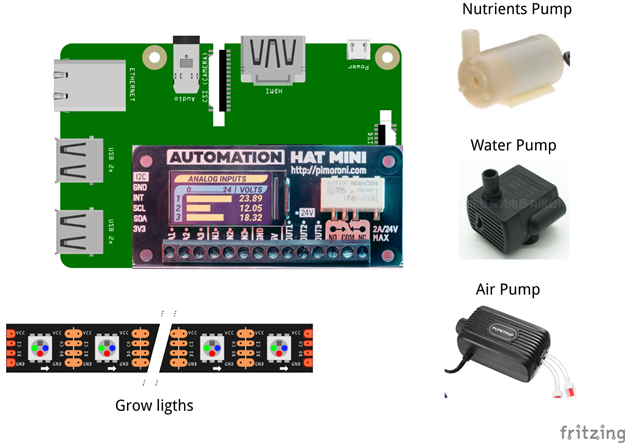

Raspberry PI 3B+
The Automation HAT mini will be connected to this Raspberry PI. It will control:
  • Water Pump
  • Air Pump
  • Nutrients PUMP
  • Grow Lights
The pumps will be controlled using the web services or the timers defined in the code.

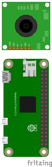

Raspberry PI Zero
The raspberry PI zero will send daily updates to the Space Vegetables Twitter account.
With a camera it will take pictures of the vegetables grow status, along with same environmental status and post it to Twitter. The code to post to Twitter has already been shared here, if someone wants to know how to do it.
The environmental parameters will be requested using the Web Services provided by the Raspberry PI 4. In time, all the code will be shared.
