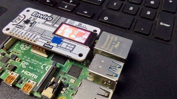

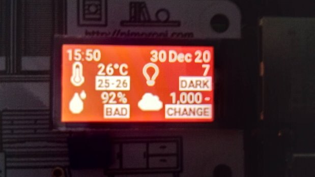

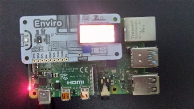

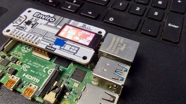

Getting Started with Pimoroni Enviro Hat:
          To get started with the Enviro hat first open the terminal by entering
Ctrl + Alt + T
Now the terminal opens up. Clone the Enviro hat examples repository into the Pi using the Command,
git clone https://github.com/pimoroni/enviroplus-python.git
Now enter into the examples directory and run any of the example.
cd enviroplus-python/examples/
python <example>.py
{gallery}Enviro Hat

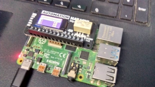

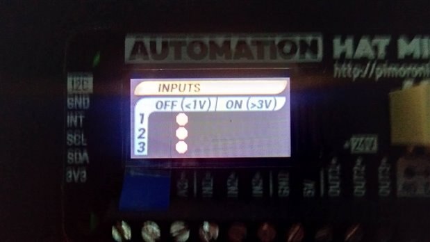

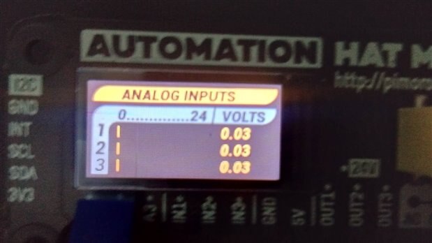

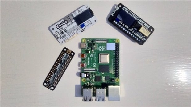

Getting Started With Pimoron Automation Hat Mini:
          To get started with the Automation Hat Mini first open the terminal by entering
Ctrl + Alt + T
Now the terminal opens up. Clone the Automation Hat Mini examples repository into the Pi using the Command,
git clone https://github.com/pimoroni/automation-hat.git
Now enter into the examples directory and run the example by using the command,
cd automation-hat/examples/hat-mini/
python <example>.py
{gallery}Automation Hat Mini
