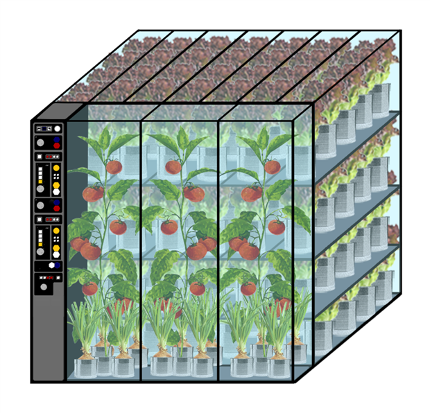

Here is an drawing I made to illustrate the spatial arrangement of the plants. (Note: I have omitted components such as LEDs because the purpose of this drawing is to validate the spatial arrangement of plants.) The chamber opens like a refrigerator from the left-hand side where the control panel is featured. Since my design is inspired by the layout of a refrigerator, accessing the crops are intuitive and easy. Tomatoes are positioned at the side of the chamber that swings open so that whenever the astronaut opens the chamber for the daily harvest, vibrations shake pollen from the tomato. This is a fantastic effect because this eliminates the need to manually tap each tomato for pollination. (Fruits require pollination, but there are no pollinator bees in space so astronauts are responsible for pollination!)
Here's the math: 1 meter = 100 centimeters. Lettuce head grows to approximately 15 cm in height and 15 cm in diameter after about four weeks of growth.
If we stagger the growth phases in a single column of lettuce so that we have 4 different heights, the heights are 4 cm, 8 cm, 12 cm, 16 cm = 40 cm total. (when 16 cm lettuce are harvested, move 12 cm lettuce to 16 cm, 8 cm to 12 cm and so forth. Plant a new lettuce at 4 cm. This happens every weekly since lettuce takes four weeks to grow and we have four lettuce.)
Each pot system is 10 cm in height so that's 40 cm.
Between LED strips and plants, there must be a minimum clearance of approximately 5cm so that light can reach each leaf; this also prevents plant stress due to heat emitted from LEDs. Each lettuce needs to be spaced 5cm away from the LEDs so that's 20cm.
40 cm total lettuce height + 40 cm pot system height + 20 cm LED spacing height = 100 cm height total. This makes full use of the height.
7 columns with each representing a day of the week. Since lettuce can be harvested every week in each column, and with a week's worth of columns (i.e. 7 columns) we have lettuce harvest daily. As for length of rows, we wish for lettuce to take up 75% volume or 75 centimeters. 5 lettuce x 15 cm = 75 cm. Perfect!

    DAB over 5 years ago
    Nice update.
    Yes, a staggered crop puts you into a sustainable harvest pattern.
    Well done.
