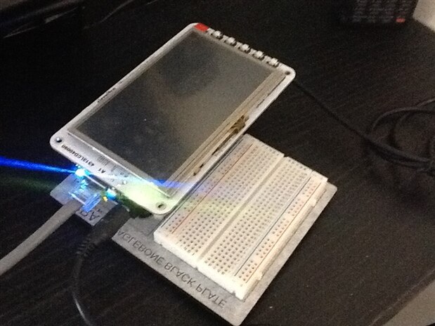

I admit to requiring a moment to figure out exactly how the LCD display mounts on top of the BeagleBone Black, since there wasn't any documentation specifically
explaining which direction it was to be mounted.  Fortunately, on closer inspection you discover that the display can only be mounted successfully in one
orientation.  A quick confirmation on the Internet proved my deduction correct.
For your own reference, the LCD display mounts with the left side of the display above the 5 V power connector and ethernet connector of the BeagleBone Black.  The
right side of the LCD display, which contains the 5 pushbuttons for controlling the display, hangs over the right side of the BeagleBone Black above the USB
connector.
The display is easy to mount into the 2 sets of header sockets on the top of the BeagleBone Black.  There isn't any set up required, just plug it in and reboot
your BBB and voilà you have your LCD display.  With the keyboard plugged in you have a complete self-contained standalone Linux-based computer.

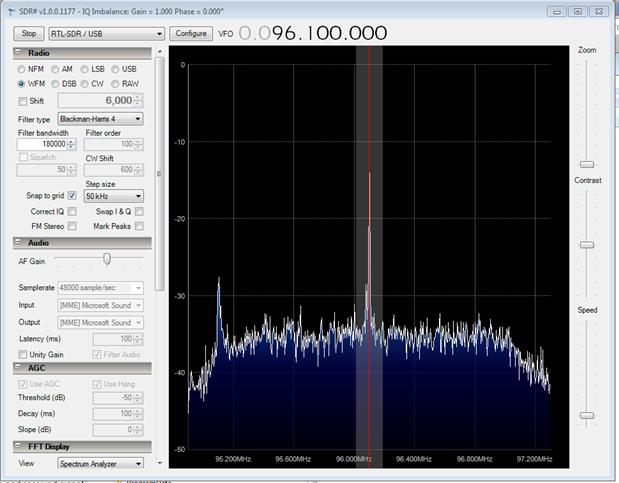

Since I had no previous experience with the USB SDR dongle, I felt the best way to proceed was to start by connecting it to my desktop PC.  After doing some
research on the web, I found and downloaded several Windows-based software packages which would interface with the SDR.
I have experimented with the following:
  • HDSDR (http://www.hdsdr.de/)
  • WinRad  (http://winrad.org/)
  • SDR# (http://sdrsharp.com/)
While each of these offer slightly different features, the SDR# was the easiest to install and get operational.  I was able to confirm that my USB SDR dongle was
capable of receiving local commercial FM broadcast signals.
