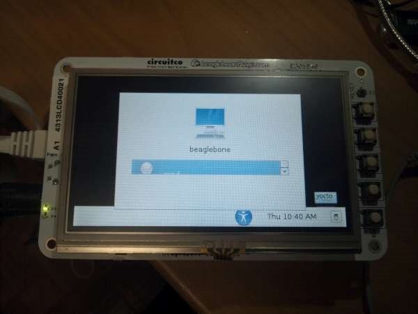

After this, you have a brand new system. It even works with the LCD4 cape out of the box. But If you look at the image name, it is a pretty old image and there are packages need upgrading. For this, I plug in the Ethernet cable in and power it up. I can see it got a IP from my router, so I SSH into it by using the username root and no password. Angstrom uses opkg as it's package manager so you just run
opkg update
opkg upgrade
You have to wait a while again as it upgrades many packages. Again "This will take a while, so do something productive. Or not productive." After it's done, you can reboot your system. Connect to it again via SSH. If you have an LCD4 cape attached, you'll see that the autologin is disabled. Basically you'll see the login screen asking you to select a user.
This is something you may want to fix. You have to open /etc/gdm/custom.conf with vi and insert the following under [daemon]
TimedLoginEnable=true
TimedLogin=root
TimedLoginDelay=10
This will login as root after you reboot your system.

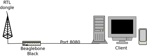

8080 is the port I chose for streaming it, you can change it as you wish. On my laptop with netcat and aplay installed, I can listen to some Japanese radio.
tayken@tayken-labtop:~$ netcat 192.168.1.5 8080 | aplay -r 44.1k -t raw -c 1 -f S16_LE
Playing raw data 'stdin' : Signed 16 bit Little Endian, Rate 44000 Hz, Mono
^CAborted by signal Interrupt...
One word of warning is the server will quit if you terminate the client connection with CTRL-C as the messages are sent both ways on netcat. One workaround is to put the server in a while loop so that each time the client sends the exit signal, it starts again. You can do this with
root@beaglebone:~# while true; do rtl_fm -f 82.5M -s 44.1k - | netcat -l -p 8080; done
You'll have to send rapid a few interrupt signals on the server shell to stop it. Here is a network diagram explaining this system. I'm putting it here as I'll be adding another server to this chain for streaming purposes.
