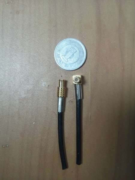

The stock antenna does not give you enough range so it's better that you make your own antenna. RTL dongle uses MCX connectors, which are small, so I bought both straight and right angled MCX jacks, a coaxial cable crimper and a few meters of 1.5C-2V coaxial cable. The cable I chose was locally available from Akihabara and it was a suitable size for the MCX connectors and the right impedance, 75 ohms, for the RTL dongle. I connected one straight and one right angled connector to short lengths of coaxial cable. Here you can see them before I put the heat shrink tubing on to blend in the crimped ferrule, 1 yen coin is for reference.
My initial decision was to follow this tutorial and make a colinear antenna. But as it turns out, wavelength for 1090 MHz is roughly 275 mm and this means my antenna has to be about 55 cm long! Not suitable for mobile use. Then I decided to make a real simple dipole antenna via this tutorial. I directly soldered the center conductor and jacket to short lengths of wire, secured it to a chopstick for stability, trimmed the antenna to size and wrapped it with electrical tape.
Now I have a real ghetto antenna for ADS-B.
