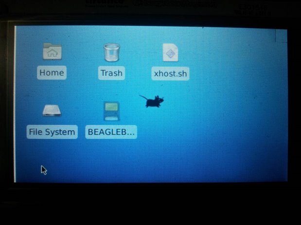

After progressing with setting up RTL_SDR software and USB audio, the next task was developing Graphical User Interface. It turned out to be a real pain. I couldn't bring up a simple window on the screen. The main culprit was GNOME!!!! It consumed almost two weeks of my effort with no success. Later I had to find an alternative. So, I chose Xfce. Turned out that it has better response time than GNOME.
Steps to enable xfce on Beaglebone Black
opkg install packagegroup-xfce-base
This will download and install all the required packages.
Next disable the GNOME Display Manager using following command
systemctl disable gdm
In order to start the xfce desktop a service should be started. So create a service file "xfce4.service" at /lib/systemd/system/ location
vi /lib/systemd/system/xfce4.service
and update it with the following content,
Unit]
Description=Xfce4 Display Manager
After=systemd-user-sessions.service
[Service]
ExecStart=/usr/bin/startxfce4 -nodaemon
StandardOutput=syslog
[Install]
Alias=display-manager.service
Then start the service using systemctl and reboot BBB,
systemctl enable xfce4
reboot
After reboot the Desktop screen will look something similar to this,

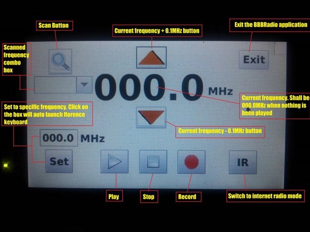

RTL_SDR GUI
Below is the image describing the various elements available to the user,
In order to start, RTL_SDR has to be connected to BBB, else a message box shall pop up asking for proper connection of RTL-SDR and BBB.

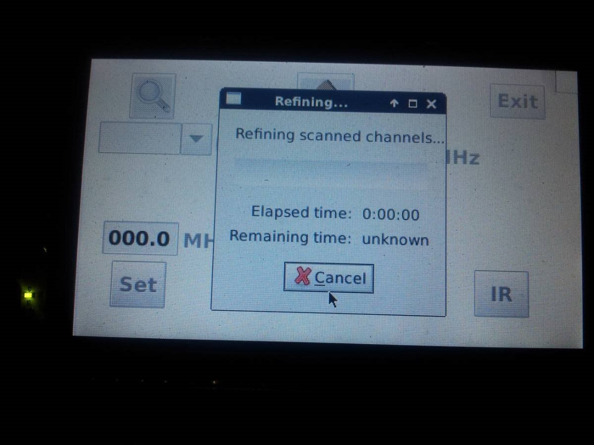

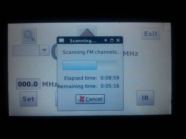

Scanning of available FM stations feature is implemented using python. The progress is displayed on the screen as shown below,
The scanning range starts from 87.5MHz to 108MHz with a resolution of 0.1MHz. Hence it takes almost 14 mins to complete the scan. After scanning, obtained results are doubled checked for valid station,
The scanning process can be interrupted at any moment. After the second level check, the available channels are listed in combo box as shown below,

BBBRadio can be tuned to user defined frequency using Set frequency available on bottom left of the screen. A click on the text box and florence virtual keyboard comes up for user input.

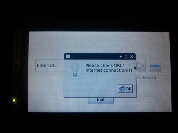

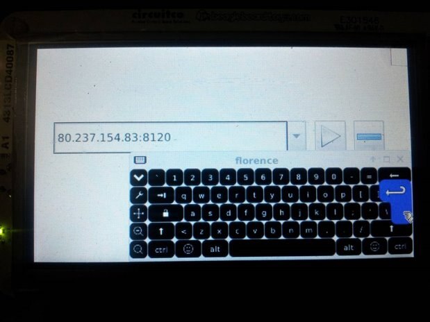

Alike the feature for Set Frequency textbox in RTL_SDR interface, Florence opens when the user clicks on the combo box to enter the URL for internet stream.
If user enters a wrong URL or if BBB is not connected to the internet, a message box pops up asking user to check the URL/internet connectivity.
For recording the stream, user has to check the Record check box before issuing play command. Both playing and recording uses mplayer. Each valid URL entered by user is remember by BBB by writing to file at data folder and retrieving at the time of dialog opening. User can remove any URL available in drop down of the combo box by first selecting the URL and clicking on the "Remove from the list icon"
