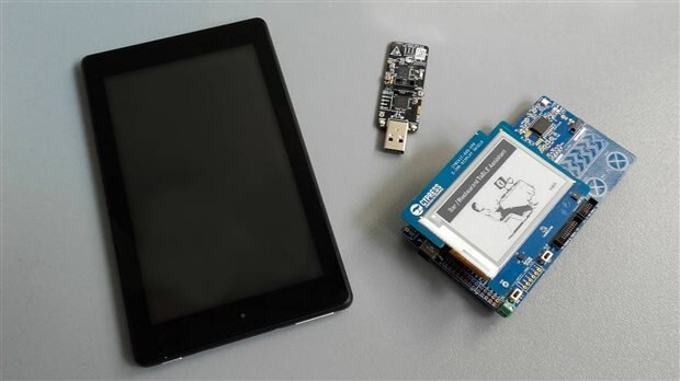

This week I moved onto the challenge of determining which solution would make the ideal “maître d'” for the system, as in, which type of device would provide both the best central control function and the best user satisfaction.
I had three BLE-enabled candidates to consider, namely an Android tablet (in my case I'm testing on an Amazon Fire 7" tablet), a Cypress CY5677 USB dongle and a PSoC 6 BLE Pioneer board with E-Ink Display Shield, which I had initially suggested would act as the central device in blog #1.

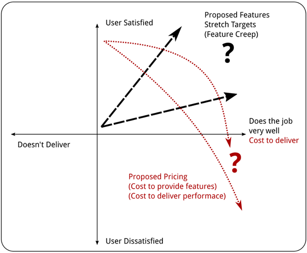

So I needed some sort of evaluation tool to determine the best outcome for the project. The theory is fairly simple, in that you want your customers to be satisfied with what the product does and with how much they paid for it.
It was time to evaluate the customer requirements, from the maître d's (or owner/manager’s) perspective against the technical specifications required to deliver these and then consider the strengths and weaknesses of the design resource to actually develop something that works well, without breaking the budget and exceeding the project timeline (i.e. make a judgement on risk of failure).

So, my conclusion following this exercise, is that the PSoC 6 BLE Pioneer Kit with eInk Display Shield can be ruled out (it will just be used as the table device) and that there is no obvious clear winner between an Android tablet and a USB dongle. It will probably come down to individual user preference.

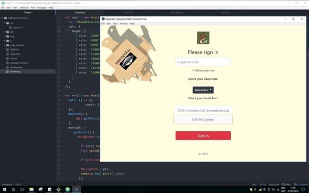

For the desktop application, I decided to try out ElectronJS as the website said some encouraging words: “If you can build a website, you can build a desktop app. Electron is a framework for creating native applications with web technologies like JavaScript, HTML, and CSS. It takes care of the hard parts so you can focus on the core of your application.” Now that sounds good to me.
In fact, trying out ElectronJS for the first time proved to be a great decision on my part. It did not take too long to create a basic landing page, using the bootstrap template and to get my application to detect the USB dongle’s serial port. To achieve this, I also incorporated the Vuejs JavaScript framework, which I also had never used before.
The really nice thing about ElectronJS is that you can use NodeJS components which you can download using the Node Package Manager or NPM. The key one to use is called Node SerialPort. On this page it provides all the necessary installation instructions, including what you need to do when using ElectronJS - "If you require serialport as a dependency for an Electron project, you must compile it for the version of Electron your project's using."
The tricky part, well for me anyway, was incorporating the Serial Port code into my Vuejs-based  JavaSript code. I eventually stumbled upon this solution to provide me with a listing of devices connected to my PC's serial ports. Here is a code snippet which I have in my "renderer.js" file.

Here is a screenshot of my landing page for the application, showing that it had recognised that 2 devices were connected to the desktop serial ports. imageimageimage
So, in my opinion, this ability to create desktop apps which can also interface with the serial port, has just supercharged that Cypress USB BLE dongle into becoming an extremely versatile hackable device. Now, that is rather nice!

    Nice work. I do like the chart to show Customer Satisfaction against needs. We have a project currently that would suit this and show it's below the horizon on nearly every aspect. Mark

    Know all about it. Real world demands such as deadlines and budgets will normally always create compromise somewhere.
