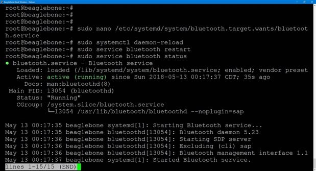

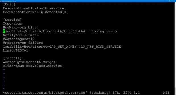

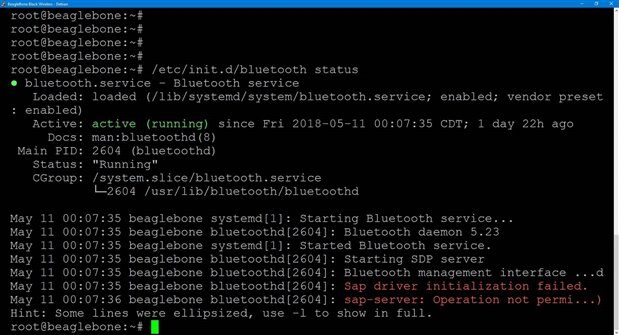

Note that I received the following error when displaying the Bluetooth status:
beaglebone bluetoothd[2604]: Sap driver initialization failed.
beaglebone bluetoothd[2604]: sap-server: Operation not permi...)
To get rid of the error we need to edit the /etc/systemd/system/bluetooth.target.wants/bluetooth.service file. The example in Figure 2 uses nano since it is easy to use. By the way my favorite editor is vi. It is a more powerful editor than nano. However, vi has a steep learning curve. Hence, nano is my editor of choice for displaying examples.
  1. Run “sudo nano /etc/systemd/system/bluetooth.target.wants/bluetooth.service” (Figure 2).
  2. Change the line : ExecStart=/usr/lib/bluetooth/bluetoothd to: ExecStart=/usr/lib/bluetooth/bluetoothd --noplugin=sap
  3. Enter Ctrl-O to save the file. When the file name is displayed press the Enter key.
  4. Then enter Ctrl-X to exit nano
  5. Run “sudo systemctl daemon-reload” to reload systemd.
  6. Run “sudo service bluetooth restart” to restart the Bluetooth service.
  7. Run “sudo service bluetooth status”. Note that the error message is gone (Figure 3).

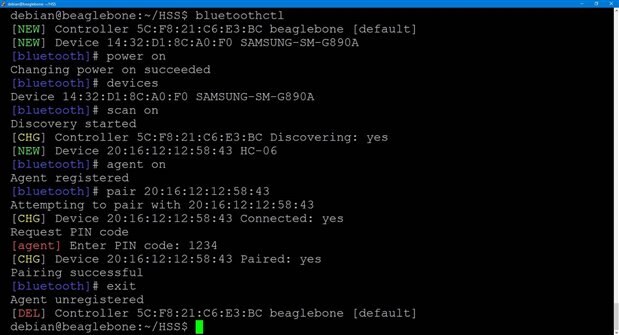

  1. Run “bluetoothctl” (Figure 4).
  2. To ensure the Bluetooth device is powered on. Enter “power on”.
  3. Enter “devices” to see available Bluetooth devices that the BeagleBone knows exist.
  4. If the target device is not displayed enter “scan on”. Any nearby Bluetooth devices will be displayed.
    1. Note the MAC address of the device to pair to. In this example, we will pair to the HC-06 Bluetooth device.
  5. We need to turn on the agent so that we can enter the PIN code when requested. Enter “agent on”.
  6. We can now pair the devices. Enter “pair 20:16:12:12:58:43”
  7. Enter “1234” to the prompt: [agent] Enter PIN code:
    1. The following messages are displayed:
      1. [CHG] Device 20:16:12:12:58:43 Paired: yes
      2. Pairing successful
  8. Enter “exit” to terminate the bluetoothctl utility.
  Figure 4.

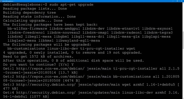

Section II – Install the PyBluez Development Libraries

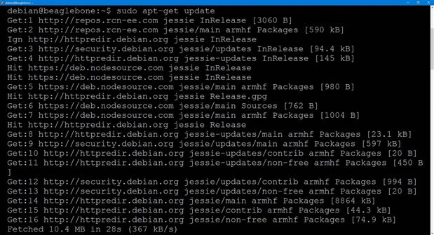

Now that the BeagleBone and the Arduino are paired we need to install the libraries needed to create the Bluetooth program. We are going to use PyBluez development libraries, so we need to install the libraries on our BeagleBone Black. First, we need to ensure that our system is up-to-date. Therefore, we need to run “sudo apt-get update” (Figure 5) and “sudo apt-get upgrade” (Figure 6). Remember to answer “Y” to the message: Do you want to continue? [Y/n].
   Figure 5.
  Figure 6.

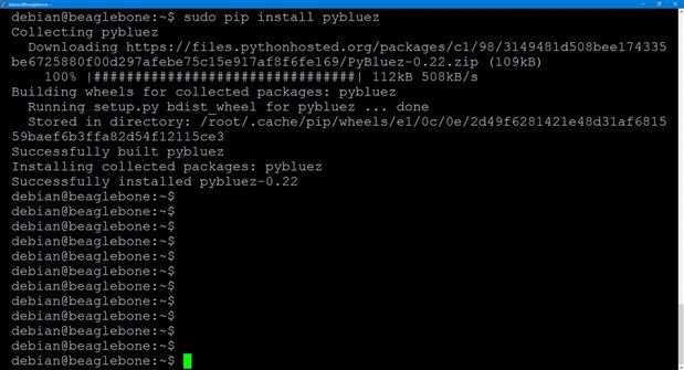

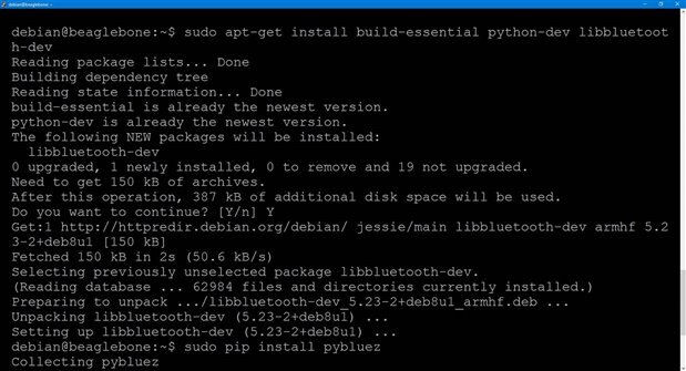

Now that our BeagleBone Black is up-to-date we need to install PyBluez libraries. We need to verify that the build-essential libraries are up-to-date.
Run “sudo apt-get install build-essential python-dev libbluetooth-dev” (Figure 7).
  Figure 7.
Once the build-essential libraries are up-to-date we can install PyBluez libraries. Run “sudo pip install pybluez” (Figure 8).
  Figure 8.

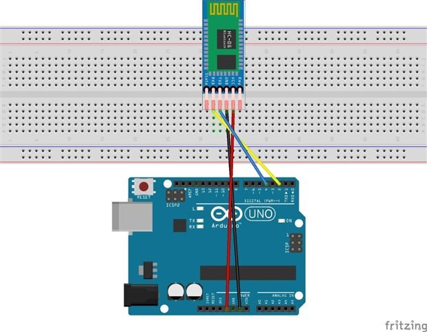

Section IV – Connect the HC-06 to the Arduino
Now, insert the HC-06 into a breadboard (Figure 11) and wire it to the Arduino.
  • Connect a jumper wire from the receive pin on the HC-06 to the transmit pin on the Arduino (pin 2).
  • Connect a jumper wire from the transmit pin on the HC-06 to the receive pin on the Arduino (pin 4).
  • Connect a jumper wire from the ground pin on the HC-06 to the ground pin on the Arduino.
  • Connect a jumper wire from the VCC pin on the HC-06 to the 5-volt pin on the Arduino.
  Figure 11.

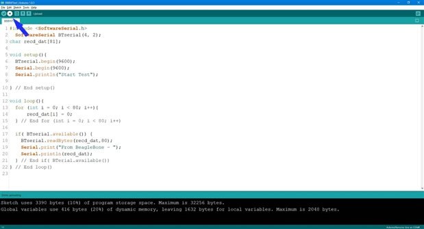

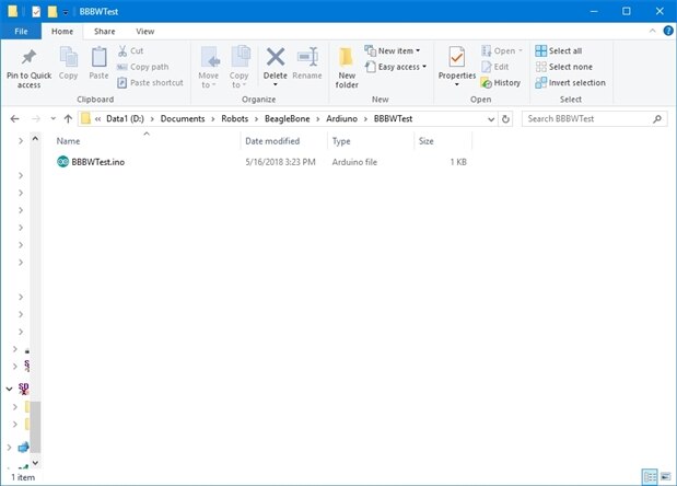

We are ready to test our Bluetooth connection. First, we need to load the BBBWTest sketch so it can wait for a transmission from the BeagleBone Black.
Double click on the BBBWTest.ino file (Figure 12).
Click on the Upload button (Figure 13) to load and execute the BBBWTest sketch.
  Figure 12.
  Figure 13.

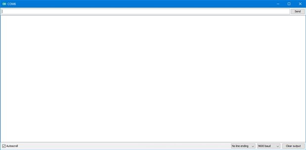

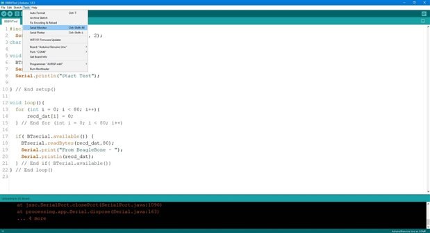

We need to start the Serial Monitor so we can display the data passed by the BeagleBone Black. In the Arduino IDE, click on the Tools menu and select Serial Monitor (Figure 14). The Serial Monitor is displayed (Figure 15).
  Figure 14.
  Figure 15.

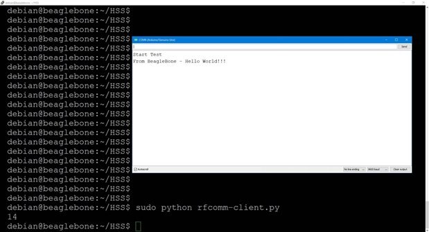

Create a Putty session to the BeagleBone Black. Then execute the rfcomm-client python program.
Run “sudo python rfcomm-client.py” (Figure 16).
As shown in Figure 16, the BBBWTest sketch displays “Start Test” in the Serial Monitor. When the rfcomm-client python program is started, it will connect to the Bluetooth device attached to the Arduino and send it the “Hello World!!!” text. When the BBBWTest sketch receives the text, it will display it in the Serial Monitor (From BeagleBone – Hello World!!!).
We now know that the Bluetooth adaptor on the BeagleBone Black is working correctly.

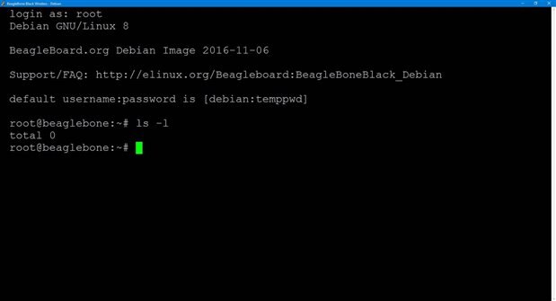

I do not know how I forgot to add this last time but I did. Debian version 8 (Jessie) installs without a root password. Make sure you give it one.
Logon as root. Once you enter root as the username Debian will log you on (Figure 17).
  Figure 17.

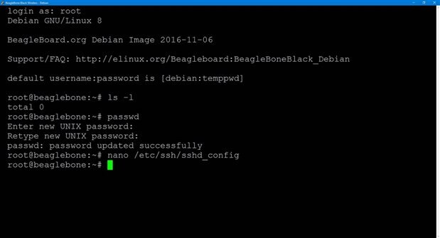

Run “passwd”. Notice that Debian will not ask you for your old password because there is not one (Figure 18).
Enter your new root password twice.
  Figure 18.

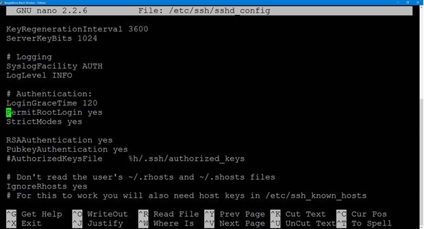

Your root password is now secure however, you can lock down the root username even more. There is no reason to logon as root remotely once you are finished installing the Debian operating system. So, let us turn off remote root logon.

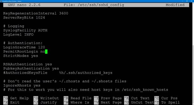

We need to edit the /etc/ssh/sshd_config file. Read the /etc/ssh/sshd_config file into your favorite editor. The example in Figure 19 uses nano since it is easy to use.
  1. Run “nano /etc/ssh/sshd_config”
  2. Press Ctrl-W
  3. Enter PermitRootLogin and then press the Enter key to perform the search.
  4. Change yes to no (Figure 20).
  5. Enter Ctrl-O to save the file. When the file name is displayed press the Enter key.
  6. Then enter Ctrl-X to exit nano.

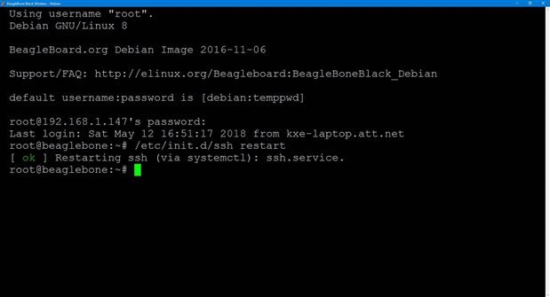

  7. The change will not take effect until you restart the SSH server.
    1. Run “/etc/init.d/ssh restart” (Figure 21).

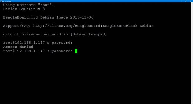

Now Debian will not allow you to logon as Root remotely (Figure 22).
