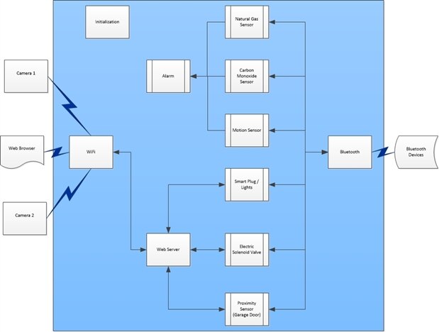

Section I – High Level Design for the BeagleBone Black Software
There are four main software modules, the Initialization module, the Wi-Fi module, the Web Server module, and the Bluetooth module (See Figure 1). There are seven sub-modules, Natural Gas Sensor sub-module, Carbon Monoxide Sensor sub-module, Motion Sensor sub-module, Alarm sub-module, Smart Plug / Lights sub-module, Electric Solenoid Valve sub-module, and Proximity Sensor (Garage Door) sub-module.
The Initialization module is a standalone module. Its purpose is to ensure that the other modules are started properly.
The Wi-Fi module has two functions. One function is for communications between the BeagleBone Black web server and the home owner’s web browser. The second function is for accepting a camera stream from the two cameras and passing the streams to the Web Server module for displaying on the home owner’s web browser.
The web server module accepts data from the sub-modules and passes the data to the web browser. It will also accept the home owner’s browser responses and passes those responses back to the sub-modules for processing.
The Bluetooth module accepts data from the Bluetooth devices and passes the data to the appropriate sub-module. The sub-modules process the data and passes responses back to the Bluetooth module which sends the data back to the appropriate Bluetooth device.
The Natural Gas Sensor, Carbon Monoxide Sensor, and Motion Sensor sub-modules processes the data from its corresponding sensor. If the sensor is triggered it sends an alert. The appropriate sub-module formats a message and the message is sent to the Alarm sub-module. The Alarm sub-module sounds an alarm by making a beeping sound and speaking a message via speech-to-hardware.
The Smart Plug / Lights sub-module processes data from smart plugs and lights. Basically, the sub-modules will accept requests from the home owner to either turn a light / appliance on or off. The request is passed to the Bluetooth module and sent to the appropriate Bluetooth device.
The Electric Solenoid Valve sub-module is similar to the Smart Plug / Lights sub-module. The main difference is the Electric Solenoid Valve sub-module controls a solenoid value instead of a smart plug or light. The solenoid value will act as an on-off switch for a gas stove.
The Proximity Sensor sub-module will control the garage door. The proximity sensor module will send the status of the garage door (open or closed) via Bluetooth to the Proximity Sensor sub-module. The Proximity Sensor sub-module will interact with the home owner via the web browser to close or open the garage door.
  Figure 1.

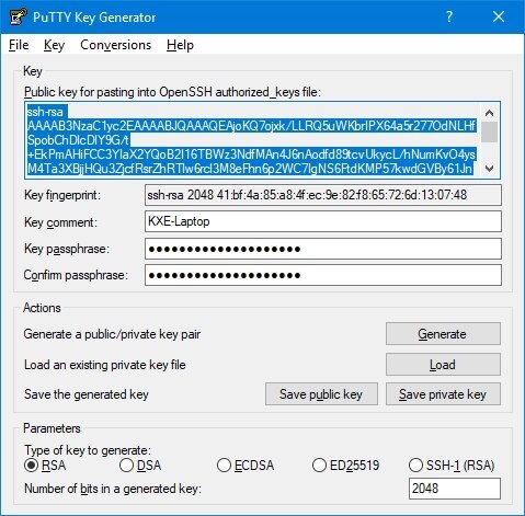

In Post II, I showed you how to install PuTTY. PuTTY comes with a utility called PuTTYgen and another utility called Pageant. With PuTTYgen you can generate SSH key pairs. Pageant is used to help manage your private keys. Storing your private key in Pageant allows you to log onto your BeagleBone Black without a password.
For those unfamiliar with public key authentication here is a short description extracted from the PuTTY documentation:
You generate a key pair, consisting of a public key (which everybody is allowed to know) and a private key (which you keep secret and do not give to anybody). The private key is able to generate signatures. A signature created using your private key cannot be forged by anybody who does not have that key; but anybody who has your public key can verify that a particular signature is genuine.
So, you generate a key pair on your own computer, and you copy the public key to the server. Then, when the server asks you to prove who you are, PuTTY can generate a signature using your private key. The server can verify that signature (since it has your public key) and allow you to log in. Now if the server is hacked or spoofed, the attacker does not gain your private key or password; they only gain one signature. And signatures cannot be re-used, so they have gained nothing.
Here is the process to generate SSH key pairs with PuTTYgen and to use Pageant to logon without a password.

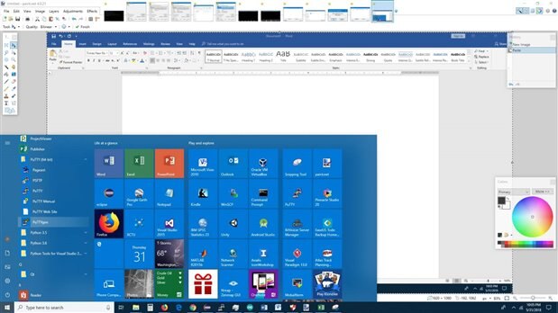

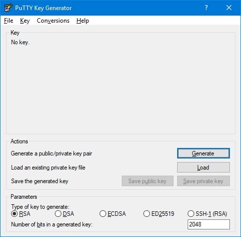

Start PuTTYgen on your PC (Figure 2).
  Figure 2.
Click on the Generate button (Figure 3).
  Figure 3.
Move you mouse around when prompted to create some randomness.

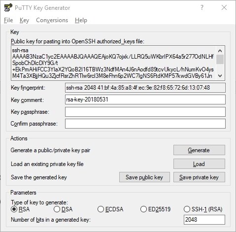

PuTTYgen will re-display the window with your public key populated in the top text box (Figure 4).
  Figure 4.

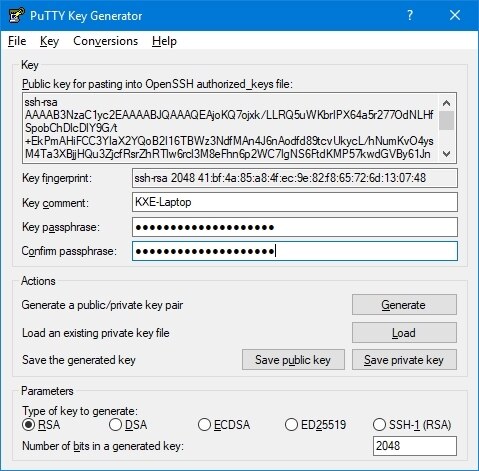

Enter something in the Key comment text box that identifies your PC (Figure 5).
Enter a strong password in the Key passphrase text boxes.

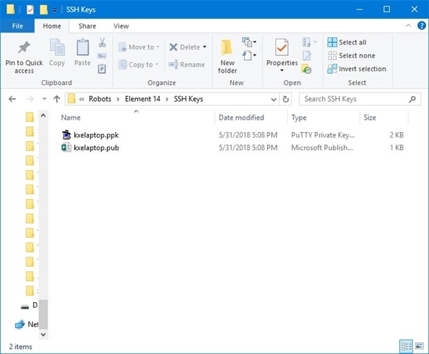

Click on the Save public key button.
Make sure you remember which directory you used to save the keys.
I called the public key kxelaptop.pub (Figure 6).
Click on the Save private key button
I called the private key kxelaptop.ppk.
  Figure 5.
  Figure 6.

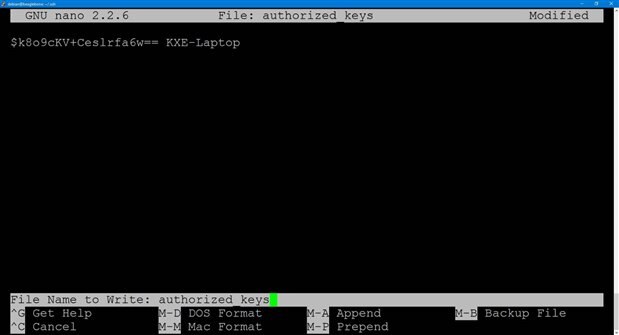

We need to create an authorized_keys file to hold PuTTY’s public key.
Run “nano authorized_keys”

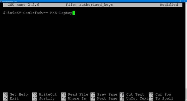

In the PuTTYgen window, copy the public key in the top text box, to the system clipboard (Figure 7).
In the nano editor:
  • Right click on the mouse -  to paste the contents of the system clipboard (Figure 8).
  • Note that the Public key is one line long, not multiple lines.
  • Enter Ctl-O to save the file. Click the Enter key when you see the prompt (Figure 9):
  • File Name to Write: authorized_keys
  • Enter  Ctl-X to exit nano.
  Figure 8.
  Figure 9.
The authorized_keys file permissions must be set to read/write for owner and no permissions for group & world. To set the permissions correctly run “chmod 600 authorized_keys”:
-rw------- 1 debian debian 787 Jun  1 00:34 authorized_keys

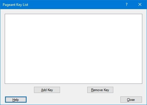

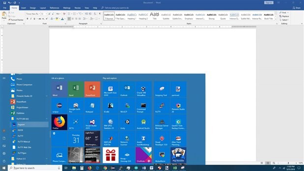

Open Pageant (Figure 10).
Figure 10.

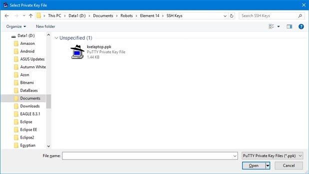

Click on the Add Key button (Figure 11).
Click on the open button and browse to your key directory and select the private key (Figure 12).
  Figure 11.
  Figure 12.

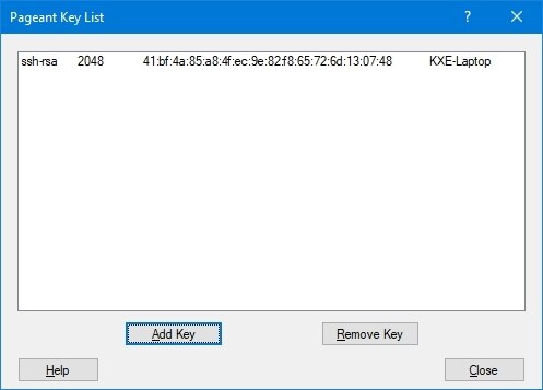

Enter your password for your private key (Figure 13).
  Figure 13.
Your private key is now stored in Pageant (Figure 14).
  Figure 14.

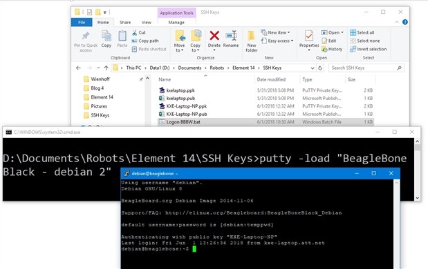

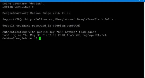

Now, start a PuTTY session as you normally would. However, this time when your PuTTY session starts the BeagleBone Black will automatically log you on (Figure 15).
  Figure 15.
Keep in mind that Pageant must be running for auto logon to work. You can add it to the startup folder so that it starts whenever you logon to your PC. The following link explains how to add a program to the startup folder if you do not know how:
https://answers.microsoft.com/en-us/windows/forum/windows_10-start/how-to-add-programs-to-startup-in-windows-10/09d4cb0a-dcd5-4521-94e8-fef293f062ce

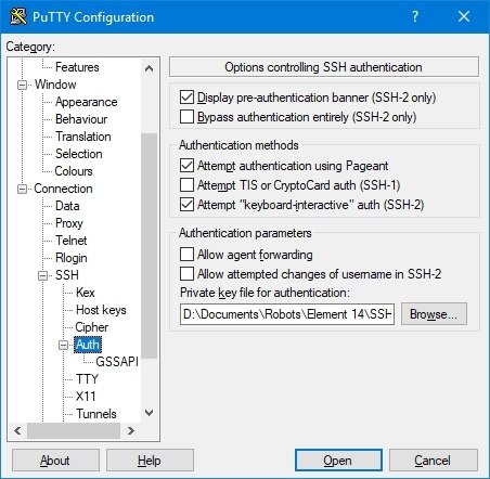

There is one caveat with Pageant. When you exit Pageant, the private keys stored in Pageant are deleted out of Pageant. Therefore, the next time you start Pageant you have to re-enter the private key. If you have your private key password protected it will ask you for the password. However, you only have to do this once every Pageant session. The keys are only deleted out of Pageant if you exit Pageant. If you close Pageant it is minimized into the System tray and is still running.
You could get around the problem by not password protecting your private key. However, it is a less secure solution. If you do not password protect your private key you could specify the path for your key in the PuTTY configuration. Just add the path in the text box next to the Browse button (Figure 16) in the SSH/Auth Category in the PuTTY configuration. Now you can logon without a password and without running Pageant. Just keep in mind that if the private key is not password protected anyone hacking into your PC will be able to see your private key since it will be stored in plaintext.
  Figure 16.

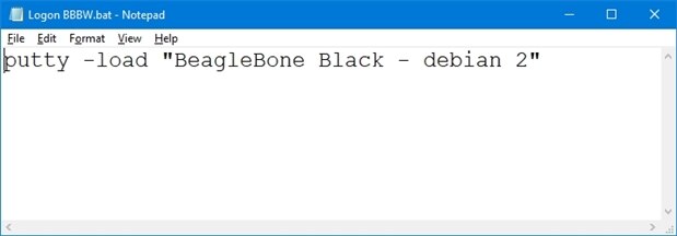

You can also execute PuTTY from a batch file. I created a PuTTY configuration file called “BeagleBone Black - debian 2”. The configuration file for BeagleBone Black - debian 2 contains the path to the private key that is not password protected. I then created a batch file called Logon BBBW.bat Which contains one line (Figure 17). If I double click on the logon BBBW.dat file it logs me on to the BeagleBone Black (Figure 18).
  Figure 17.
  Figure 18.
