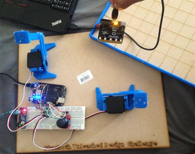

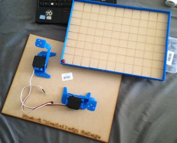

As part of this blog post my idea was to post the final steps to build the Bluetooth maze, that is putting the 3D printing and laser cutting components together and have the servo mechanism moving, but I ran into a couple of problems. Basically I have found the the MDF top sheet that I have laser cut which would have the marble roll around is too heavy for the 3D printed servo mechanism, and it snaps the blue printed parts image, and the one you see in the picture below are the 3rd version and are much more beefy.  This meant I had to rethink my design and try a bunch of things this week to get it working, with little success. So finally after watching a couple or motivational video on the youtube’s , I mustered up the courage and took the mechanism to my local maker space to get some suggestion, and spoke to folks who work on CNC and machining parts, and they had a bunch of suggestion. And the one suggestion, I think I am going to try over the weekend is to have the top plate set on a circular metallic ball , with some 3D printed parts and simplify my 3D printed servo mechanism.
image  But if you have any other suggestion please leave a comment below, and thanks in advance - Carmelito
As of now I have got the servo mechanism working and moving when I tilt the MicroBit on the pitch and roll axis and sending data via Bluetooth-UART as you see in the picture above. Here is the code that I used on the Beaglebone black wireless to move the servos on the pitch and roll values axis...

Now based on the suggestion I mentioned above, my idea over the next couple of days is to find a metallic ball/ bigger marble to be placed just above the barcode price sticker on the bottom plate in the picture below, and have two 3D printed parts hold the ball between the top plate and the bottom plate, and I am hoping this takes the weight of the servo mechanism .
    genebren over 8 years ago
    Nice update to your design challenge project.  Ouch!  They don't make plastic parts like they use to.  I too have suffered from 3D printed parts that could not handle the load required and have failed.  I wonder if you could also remove some of the weight from your MDF parts by routing out the backsides (leaving plenty of edge for stiffness) to lighten the load on the servo linkages?
    Good luck on your new designs!
    Gene
