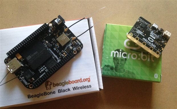

Here is a quick blog post which is a followup to my previous blog post on - setting up BlueZ on the Beaglebone Wireless , as part of the blog post I have the BBC MicroBit talking to the Beaglebone Wireless via Bluetooth.

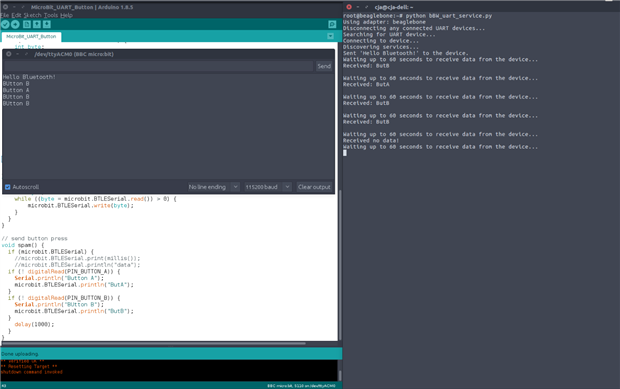

Now on the Beaglebone run the uart_service.py from the example folder , and once you see the transmission from the Beaglebone to Microbit saying 'Hello Bluetooth!', press the buttons on the Microbit and you should see them appear on the SSH teminal for the Beaglebone as shown in the screenshot below.
