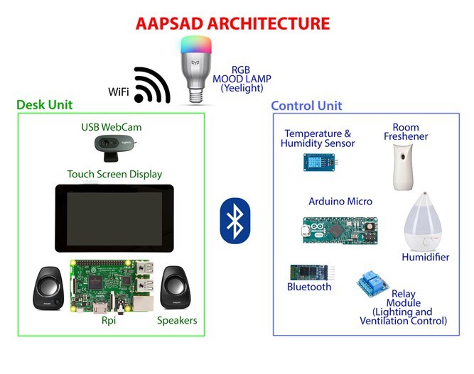

Final Architecture

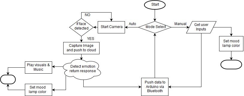

Rpi Code Flow

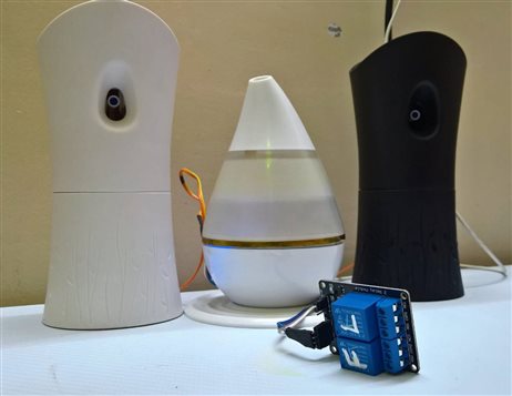

As a measure of safety I didn't hookup the Relays with the AC Mains instead the LEDs on the relay module is used to show the ON and OFF state of the Lamp and the Fan.

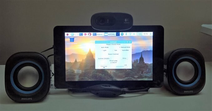

Showed it to couple of my friends they actually loved it, without saying anything I tested it over my mom and she loved it, when she's angry it really helped her out.
Here is the pin mapping everything is connect to 5VDC.
Arduino PinDevices
2Humidifier
4Fan
5Light
8
DHT11
9Bluetooth RX
10Bluetooth TX
11Room Freshener (Black)
12Room Freshener (White)
A0Light Sensor

Some might wonder why I'm using the USB webcam rather than the Rpi Camera v2.1?
The one actually came in the cart was a defective one, although danzima was ready to replace it with a new unit, I continued with my webcam, since time was running out and I had no clue where to start.

    Thank you Mark, your suggestion were always helpful, I actually ordered a couple of wireless modules for Mains control
    mcb1 over 8 years ago +3
    Well done. Nice touch not hooking up the relay as there are potential safety issues. The Learning Circuit 16: Temperature Activated Fan! Showed a very good way to control a mains circuit without the issues…
