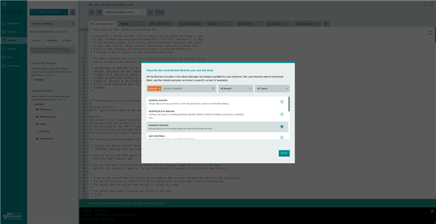

My prop will use some addressable LED strips, often referred to as NeoPixels, to have the prop light up and create a burning fire effect.
In the Arduino online editor, I searched for Adafruit's NeoPixel library and loaded the strandtest example to test my LED strip.

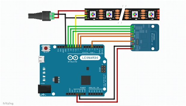

Circuit
I've created a generic circuit diagram, including the BLE module, using a combination of the RedBear's onboard wiring and Adafruit's nRF8001 wiring guide.
The Arduino is currently powered by the microUSB input, as it is still connected for programming. Once the programming is done, the Arduino will be powered from the same power source as the LED strip.

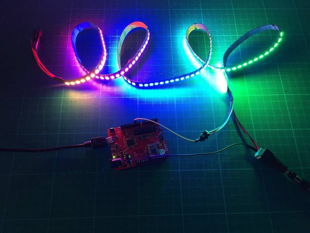

Test
To test my LED strip, I loaded the "strandtest" example and had it run. Luckily, I purchased two strips, as the first one didn't work properly and only lit up 7 of the 150 LEDs.
The second strip worked as expected:

Here's the result:

    mcb1 over 8 years ago +1
    Shame when work gets in the way of your hobby ... Adafruit recommend a capacitor across the supply line to the neoPixels. I found that without it, it did strange things to an ultrasonic detector, but once…
