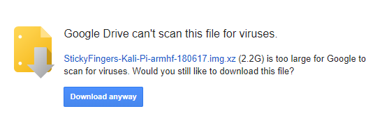

When I last left you I have a 2.2 gig file downloading so we could install our Stick Fingers Kali-Pi.
Well today when checking my computer I had a successful download, so now it is time to get this OS on a card and into some Pi!

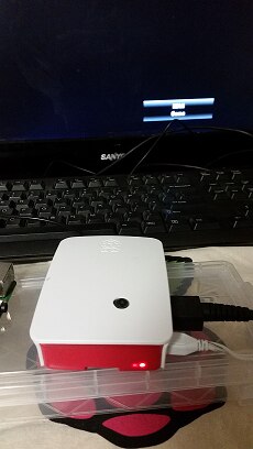

Now it is time to eject that card and place it into our Pi.  Also time to actually take those previously shown parts and put them together to see some Pi booting!
So first attempt to boot, no good.  I get power but no flicker on activity.
Out of curiosity, I pulled an older card with a dated version of Raspian and put it into the Raspberry Pi 3b+.  It gave me the Rainbow display that showed my OS was not current for the new card.
So throwing my new image into the old Raspberry Pi b shows no boot as well.
Placing the old card back into the RPi shows a fast and simple boot.  So both Pi's are looking good.

As can happen when you are grasping at IT straws I decided to try Etcher instead of Win32 Disk Imager.
This definitely took longer then the Imager, hopefully it will work!
Yes! Success!  So now you can see activity lights and Kali starting to load!  Etcher for the win in this case.  The extra cards and days of downloads could have been avoided if I tried Etcher first.  At least we have success.
