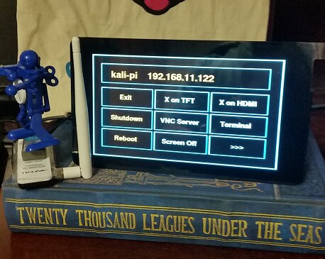

First off a picture of something cool I picked up on my trip for the Project.
You can see BlueDude getting ready to do some serious Surfing.  :-)
But the item I would like to draw your attention to is the Twenty Thousand Leagues Under The Seas.
A hollow book that hopefully will enclose Project Loki even with the 7" touchscreen!

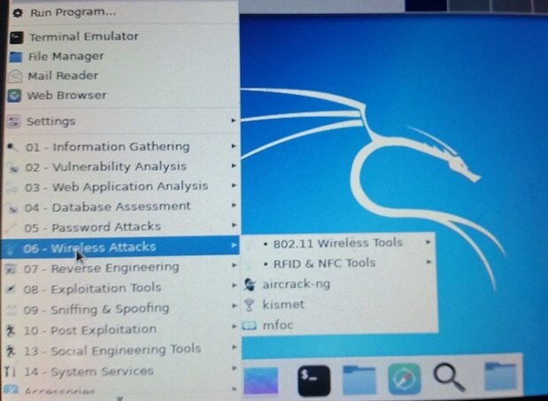

Okay, when we last blogged we decided to look and see if there were any bluetooth tools installed with this version of Kali since I was not finding anything in the StickyPi menu system.
Reading through some webinfo pages hinted that Kali should have bluetooth tools under Wireless Attacks.
Here is an example from an interesting article on null-byte.wonderhowto.com.
To see the full article please go here.  There are some other bluetooth articles there as well if you wander through.
It is a set of older articles though and as always with technology, the constant updates and upgrades can make some information historical but not accurate with current tools.
So let's see what Project Loki currently has.
Okay, as we can see our default load of applications does not seem to include any of the Bluetooth Tools.

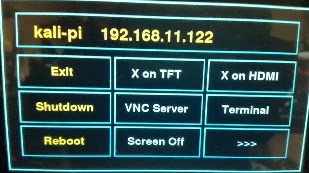

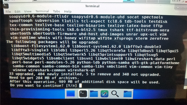

If you are still here on the menu and haven't jumped over to X on TFT, you can use the Terminal button.  I actually had been looking at things through X on TFT to see what was default installed and so I stayed there and used the Terminal option from there.

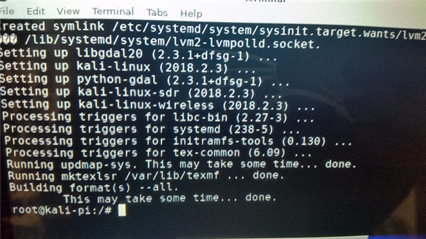

sudo apt update && sudo apt install kali-linux-wireless
This gets lengthy / time involved, so be prepared!
Keep rolling with the install.  Glad I got the 32gig card!
Yes, yes it did take some time!  But finally we are Done!

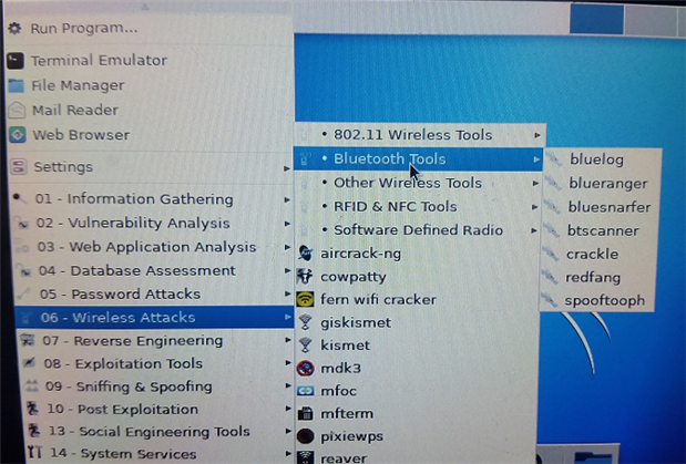

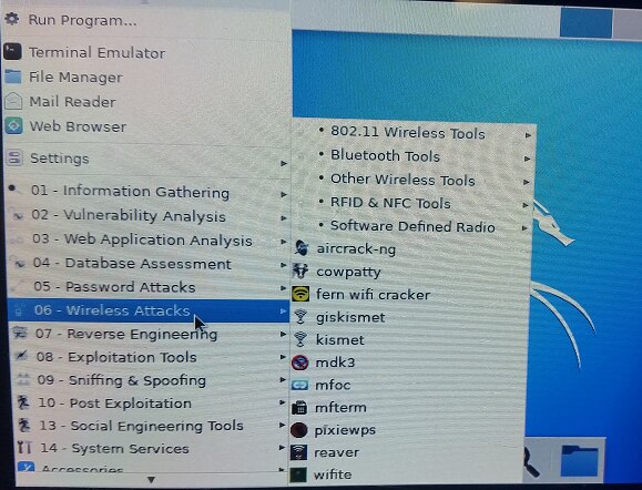

So jumping back to check our Wireless Attacks and we see quite a bit more!
Looking under Bluetooth Tools give us:
bluelog- "Bluelog is a Linux Bluetooth scanner with optional daemon mode and web front-end, designed for site surveys and traffic monitoring. It’s intended to be run for long periods of time in a static location to determine how many discoverable Bluetooth devices there are in the area."
blueranger- "BlueRanger is a simple Bash script which uses Link Quality to locate Bluetooth device radios. It sends l2cap (Bluetooth) pings to create a connection between Bluetooth interfaces, since most devices allow pings without any authentication or authorization. The higher the link quality, the closer the device (in theory)."
bluesnarfer- "A Bluetooth bluesnarfing Utility."
btscanner- "btscanner is a tool designed specifically to extract as much information as possible from a Bluetooth device without the requirement to pair. A detailed information screen extracts HCI and SDP information, and maintains an open connection to monitor the RSSI and link quality. btscanner is based on the BlueZ Bluetooth stack, which is included with recent Linux kernels, and the BlueZ toolset. btscanner also contains a complete listing of the IEEE OUI numbers and class lookup tables. Using the information gathered from these sources it is possible to make educated guesses as to the host device type.btscanner is a tool designed specifically to extract as much information as possible from a Bluetooth device without the requirement to pair. A detailed information screen extracts HCI and SDP information, and maintains an open connection to monitor the RSSI and link quality. btscanner is based on the BlueZ Bluetooth stack, which is included with recent Linux kernels, and the BlueZ toolset. btscanner also contains a complete listing of the IEEE OUI numbers and class lookup tables. Using the information gathered from these sources it is possible to make educated guesses as to the host device type."
crackle- "crackle exploits a flaw in the BLE pairing process that allows an attacker to guess or very quickly brute force the TK (Temporary Key). With the TK and other data collected from the pairing process, the STK (Short Term Key) and later the LTK (Long Term Key) can be collected."
redfang- "RedFang is a small proof-of-concept application to find non discoverable Bluetooth devices. This is done by brute forcing the last six (6) bytes of the Bluetooth address of the device and doing a read_remote_name()."
spooftooph- "Spooftooph is designed to automate spoofing or cloning Bluetooth device information. Make a Bluetooth device hide in plain site."
