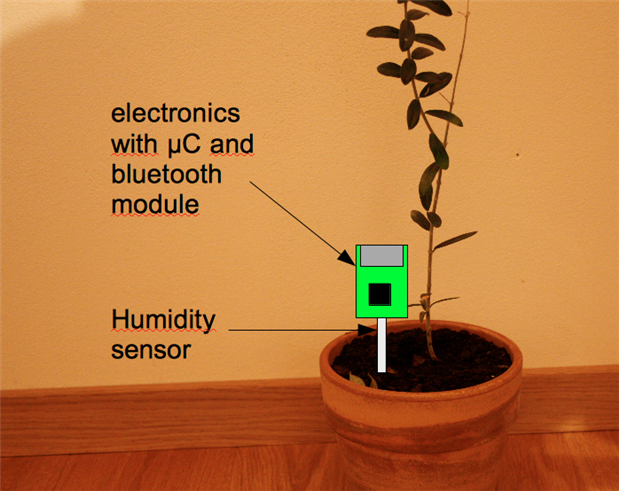

This is where my PlantProtector3100 comes in.
System overview:
The PlantProtector has to be put into the soil in the pot of every plant and measures the humidity and temperature of the soil. The devices are connected via Bluetooth. To cover larger areas I want to create a Bluetooth mesh network where each device works as a range extender for the next device. So my sensors will also work in the larger buildings like office spaces. At one point of the network it is connected to the internet and will deliver the data of the sensor to a cloud service. The user can connect to the cloud service and see all the data of the sensor and get alerts if data is out of a specific range like when the soil gets to dry and watering is necessary.
Hardware setup with STSW-BNRG-Mesh
To get a bluetooth mesh network running you some mesh network library or SDK. At the moment it seems like ST is the only company with an SDK so I will give it a try. They call it
STSW-BNRG-Mesh. You can find more information on it here: STSW-BNRG-Mesh - Mesh over Bluetooth Low Energy - STMicroelectronics
As development board i decided to use the STM -  NUCLEO-L073RZ and X-NUCLEO-idb05a1 I have addional evaluation boards and hardware from ST available that should support STSW-BNRG-Mesh and i will introduce them in my next post As internet gateway I will use a Raspberry Pi I have to figure out if I can use the built in Bluetooth hardware of the Raspberry Pi to connect to the mesh network or if I have to use an additional ST SPBTLE-RF at the Raspberry Pi to connect

If the mesh network doesn't work like show in the demo and expected my project is at risk. I could switch to a standard bluetooth network setup where each single sensor node is connected to the master/gateway (the Raspberry Pi) . This would also work somehow but the mesh network has more charm and technical advantages.
    genebren over 8 years ago +1
    Nice start to your design challenge. Mesh networks offer a lot of advantages, when it comes to large and convoluted networks. But they can also present some interesting problems/issues. I worked on a Zigbee…

    Nice start to your design challenge.  Mesh networks offer a lot of advantages, when it comes to large and convoluted networks.  But they can also present some interesting problems/issues.  I worked on a Zigbee mesh solution to office/parking garage/warehouse lighting systems. The mesh was very good at finding good connectivity through some of the complex floor plans that we installed our systems in, but sometimes there could be throughput issues as message 'storms' could pop-up, were message throughput would suffer.  Some of the solutions required 'throttling' message rates from individual devices such that they did not over stress the network.  Hopefully with your smaller, less dense network, these will not be problems for you.  It is nice that you have already begun to consider work arounds should the mesh not work for you.
    Good luck on you project!
