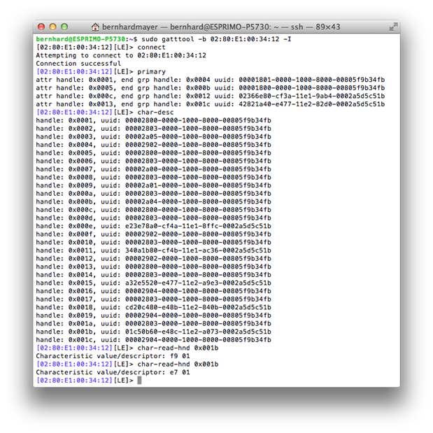

For further analysation we use gatttool and we use it in the interactive mode where we can send one command after one another to the same device. To setup the tool we use the command:
sudo gatttool -b 02:80:E1:00:34:12 -I
Then you have to connect with "connect". After successful connction the MAC address turns blue.
Then you can list the primary handles with "primary" or all handles with "char-desc". These handles are defined in the source code.
You can show the value of one handle (for example handle 0x001b) with "char-read-hnd 0x001b". This is the handle for the simulated humidity sensor and its value changes with every read.
You can see the output of all the commands in the following screenshot.
