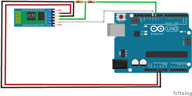

Let's start off with the Arduino, as I've said I'll be using the uno for this test. To connect it to the Raspberry using bluetooth we need a bluetooth module of some sorts. There are loads of them to choose from, I went with the HC-05. I used it in a project a few years back so I thought why not use it again. I found online a lot of different ways to wire up this part, but in the end I found this one working good for me.
Now the only thing left is to code it. The code is really short and simple since this is just a test. All I wanted to do with this test is establish communication between the Raspberry and Arduino, so the code just sends messages to the Raspberry via bluetooth, while in the upcoming blogs, I will update the Arduino code to read some button presses as well as some other things.

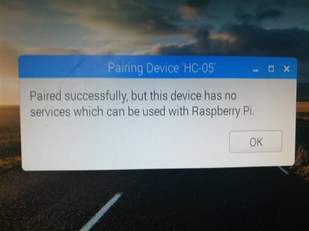

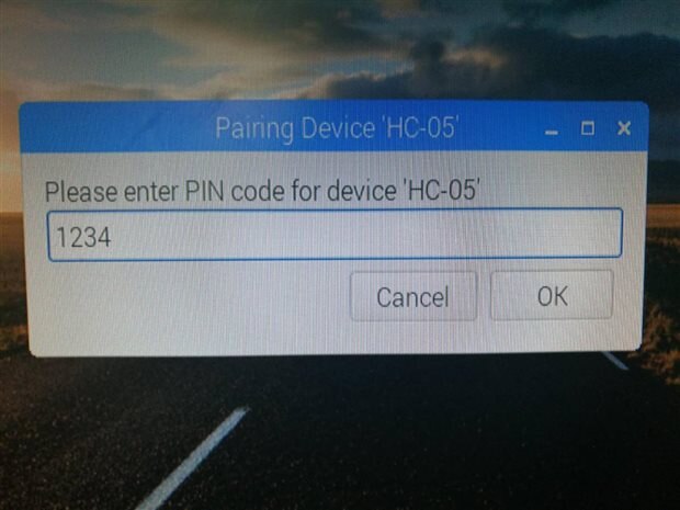

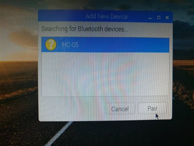

{gallery} HC-05

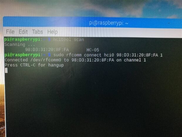

That would be all that's needed for connecting to the bluetooth module. We firstly pair it through the drop down menu on the Pi, some modules require a password while others don't, if they do, it's usually 1234 or 0000, after that with hcitool scan we find the address of the bluetooth module, and with sudo rfcomm connect hci0 98:D3:31:20:8F:FA 1 we connect the module to channel 1. Next thing and last thing we need to do is write a code that grabs data.

I've tried a few different things here but the only one that worked almost instantly without a lot of troubleshooting was this method. We firstly need a small code which will fetch data.
