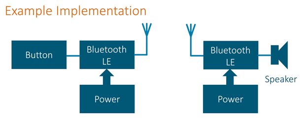

I was keen to use the Texas Instruments CC2640R2 LaunchPad board, because it uses the CC2640R2 which is really low-power. It should be ideal for both the bell push, and the chime module. However, this wasn’t the only reason. I also liked that there was the possibility of having great radio range because it supports the latest Bluetooth Low Energy (BLE or Bluetooth LE) 5.0 specification! Also, the CC2640R2 has a very powerful microcontroller inside; in fact there are several microcontrollers inside the chip. This would provide the capabilities for lots of additional functionality one day, without needing another separate microcontroller which could be difficult to fit inside a small bell push. And finally, many TI designs have a reputation for low energy. This of course is essential for the bell push which usually operates from a small battery.
My core requirements are:
  1. No wiring needed for the bell push (i.e. no power cabling or bell wire)
  2. Ability to use the chime indoors or outdoors
  3. A better range than typical wireless doorbells
  4. Ability to alert multiple chime locations from a single single doorbell
  5. Feedback to the caller, so they are aware that the chime is functioning
  6. A good service-free life, at least a year before any batteries need swapping out
On top of this, there are some additional requirements to make it a successful product, such as a ease-of-use, uncomplicated, classic look to suit most homes, interference-free, an expansion capability so that purchasers know that their investment isn’t wasted after a few years or if they move to a larger home and need longer range, and a design that is easy to expand to create many different products in the range with different chimes and alerts for instance, or with multiple buttons for use with apartments, or for controlling gates or fitted inside tables for letting the waiter know you’re ready to pay the bill. These are all scenarios where I think there could also be great benefits to using Bluetooth LE instead of proprietary RF schemes, and I’m hoping the work done in this design challenge can be applicable to a wide variety of applications.
So, while this example implementation of one possible doorbell design looks simple, I’m hoping the end result is more than flexible enough to be useful not only for different doorbell products in the range, but also for many different scenarios too.

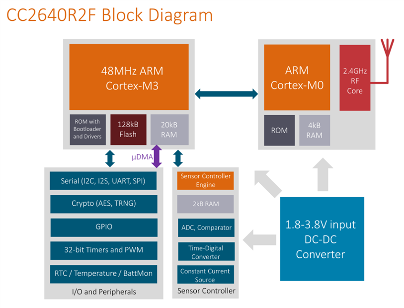

What is the CC2640R2F?
The CC2640R2F is the microcontroller that is used on the CC2640R2 LaunchPad. Internally it actually has more than one core. The main core is a powerful ARM Cortex-M3, but there is a separate Cortex-M0 that is dedicated to handling the radio tasks. Finally there is also a Sensor Controller Engine that can perform certain input-related tasks while the rest of the device is asleep! It allows for extremely low power consumption.

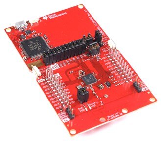

Getting to Know the CC2640R2 LaunchPad

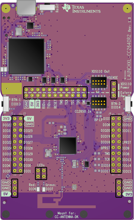

The Texas Instrument LaunchPad boards and ‘BoosterPack’ boards form an ecosystem of interchangeable microcontroller boards (these are the LaunchPad boards) and add-on boards (the BoosterPacks). It is a similar concept to Arduino boards and shields for instance. This TI system relies on two 20-way header pin blocks for connections, and often the BoosterPack boards are stackable too. Templates are available to design custom BoosterPacks too, and I will probably use that to create the wireless chime hardware functionality (such as the speaker amplifier).
Another great thing about LaunchPads is that they contain an on-board debugger that allows for programming and debugging. The top half of the board contains the debugger, and the lower half has the CC2640R2 circuit. In theory the board could be chopped in half with some care, to reduce the size of it.
Unlike an Arduino, the LaunchPad boards often have a few buttons and LEDs already connected to some inputs/outputs, so that users can immediately begin coding and testing with some basic I/O capability. The LEDs can be isolated using on-board jumpers, if desired.

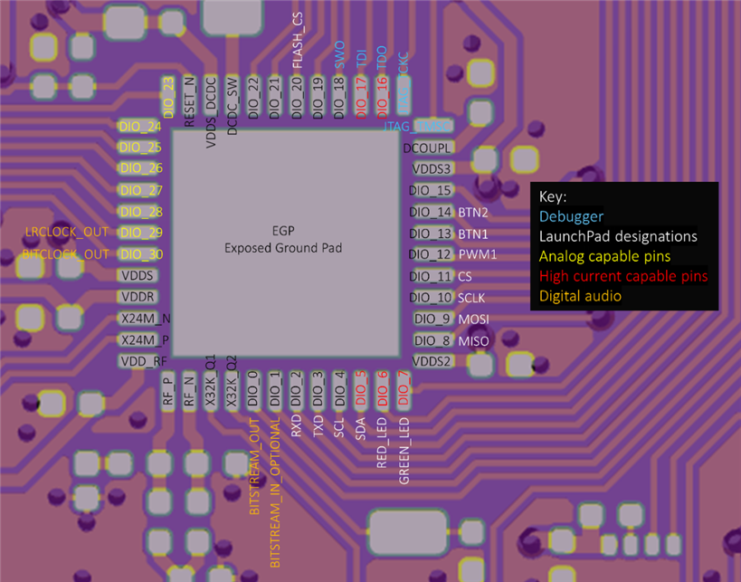

Pin Assignments
By exploring the CC2640R2 LaunchPad documentation and the CC2640R2 reference guide, it was possible to map out the pin assignments. There is a lot of flexibility; most of the input/output pins can be assigned arbitrarily to most functions. For the chime module, I may use the PWM capability to produce tones, but there is also the possibility to use the digital audio interface to produce high quality sounds. For that reason, the pins with the orange text will be assigned for digital audio. I chose these pins to be compatible with a TI audio BoosterPack in case I chose to use that during the coming weeks as the design comes together.

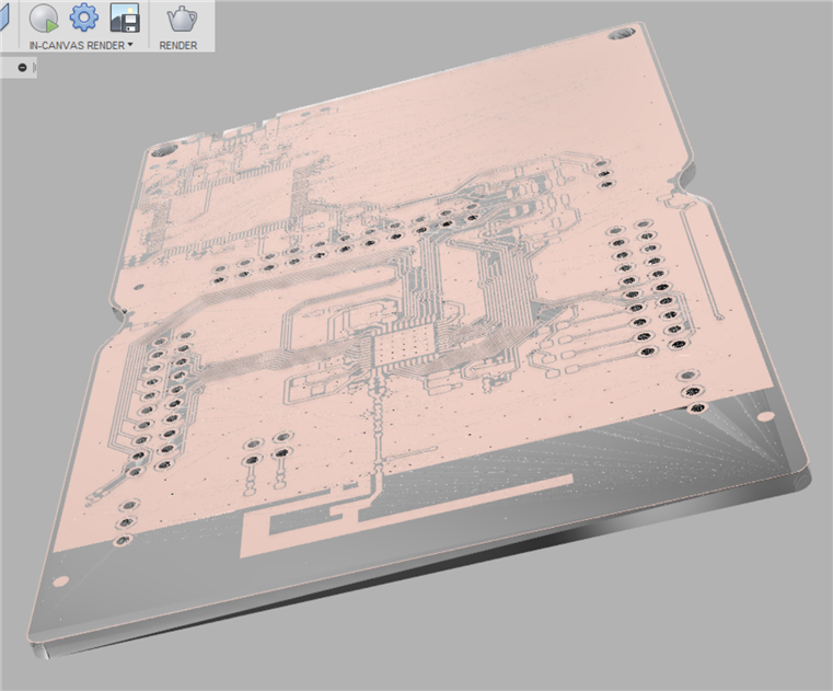

Making Enclosures with Autodesk Fusion
Texas Instruments provide a lot of information for their LaunchPad boards. This includes Gerber format files which define the PCB detail. It is possible to go from there into a 3D environment where an enclosure can be designed to fit the LaunchPad perfectly.
I’m not a 3D expert, but the process seemed feasible. The first part is to import the Gerber files into a viewer application. Viewmate from PentaLogix is low-cost and allows this. Next, you can export in STL format. This converts some of the information from the Gerber files into a 3D model. I used the file that contained the top copper and board outline. Using Autodesk Fusion, it was possible to import the STL file, and see all the precise data in the 3D CAD package.
For my project, I will most likely use an off-the-shelf enclosure for the chime unit. However, it is good to know that there is sufficient information to design and 3D print a custom enclosure for those who have such printers.
Also, for commercial designs, this exact same process could be used. The PCB designer can work with the enclosure designer and share the output from the PCB CAD tool, so that the enclosure can be accurately fitted, even for fancy curved outline PCBs and enclosures sometimes needed for consumer-friendly applications like chimes!
