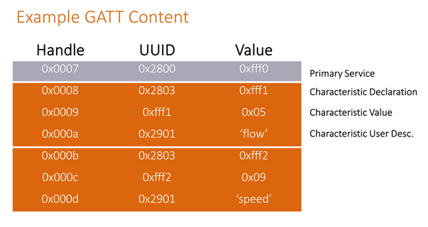

Generic Attribute Profile (GATT)
At this level of the stack, finally the information is at a level useful for applications to interact with.
The GATT protocol is used to generate attribute protocol packets with defined identifiers and handles, in a defined sequence. To take an example; if a water pump was connected via BLE then perhaps flow and speed need to be measured and transferred. In that case, the information that could be needed would be (a) indication that the device is a water pump, (b) the flow rate and (c) the speed.
With BLE this information is arranged such that (a) is indicated to be a ‘primary service’ and (b) and (c) are the values of a ‘characteristics’. Everything becomes a line in the table. This means that even the indications about what the things (a), (b) and (c) are, become entries in the table. It is easier to see by looking at an example, but it still takes a while to get one’s head around it. This table will be walked through as an example:

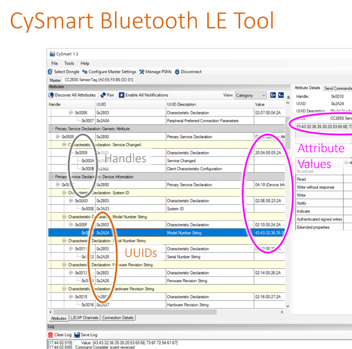

The leftmost column is just an incrementing value usually, and this is used as a handle for any read/write operations.
The first row has a UUID of 0x2800, which is a pre-defined value which means that a primary service is about to be described. It has been given a user-defined value of 0xfff0 which will mean “water pump service”. There are also pre-defined values for services.
The next row (handle 0x0008) has a UUID of 0x2803 which is another pre-defined value that means that a characteristic is about to be described. That row has a user-defined value of 0xfff1 that we will take to mean flow rate. There are pre-defined characteristic definitions too.
The next row (handle 0x0009) now contains that 0xfff1 value as the UUID. The value is the actual flow rate, and in the example it is set at 5 (e.g. 5 litres per minute).
The next line has a UUID of 0x2901 which means user description and it can be set to ASCII text if desired to describe what the characteristic was all about.
The next three rows are similar, but cover the speed of the pump.
And that’s the heart of GATT. There are additional optional things, plus there is an attribute which indicates the start of the GATT information, and other attributes for product name, firmware version and so on. But the important takeaway is that the GATT protocol defines the core ‘things’ that exist or are measurable or controllable in a product, and provides the messages that can be used to read and write the values of these core things, or to request to be notified when values of the things change.

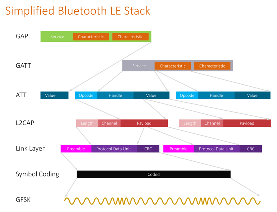

Putting the Stack Together
The diagram here shows the radio communication at the bottom, and end user applications would reside at the top. This is very simplified, but at least provides an overview of the information flows.

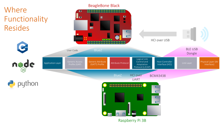

Host-Controller Interface (HCI)
Much of the stack has been described above, but one important protocol has been left out until now. It is needed for practical realisations of Bluetooth LE, because all the functionality does not usually reside on a single chip. To take an example; the Raspberry Pi has a separate chip for wireless capability. Similarly, the BeagleBone Black needs a Bluetooth LE dongle to be plugged in.
The Host-Controller Interface has been devised to sit in-between L2CAP and the Link Layer. HCI can run over USB or over serial interfaces as an example. There is not much more to say about it, except that by making it a part of the standard, it means that BLE chips, modules and cards are interchangeable, which is great.
The diagram here shows how the stack is split up between the BeagleBone Black, and a BLE dongle. The diagram looks near-identical for a Raspberry Pi, except that with the Pi 3 the radio module is on-board, and the HCI connection is not across USB but across a serial interface.
For all Linux devices, the parts of the stack northbound of the HCI are implemented using the BlueZ library of code.
BlueZ is not the nicest code to work with (it is quite badly documented) but it is what it is, and we need to work with it, or with other libraries of code that connect to it. Thus for Python users, packages such as bluepy can be used. At its heart it interfaces to BlueZ, so we don’t have to : )

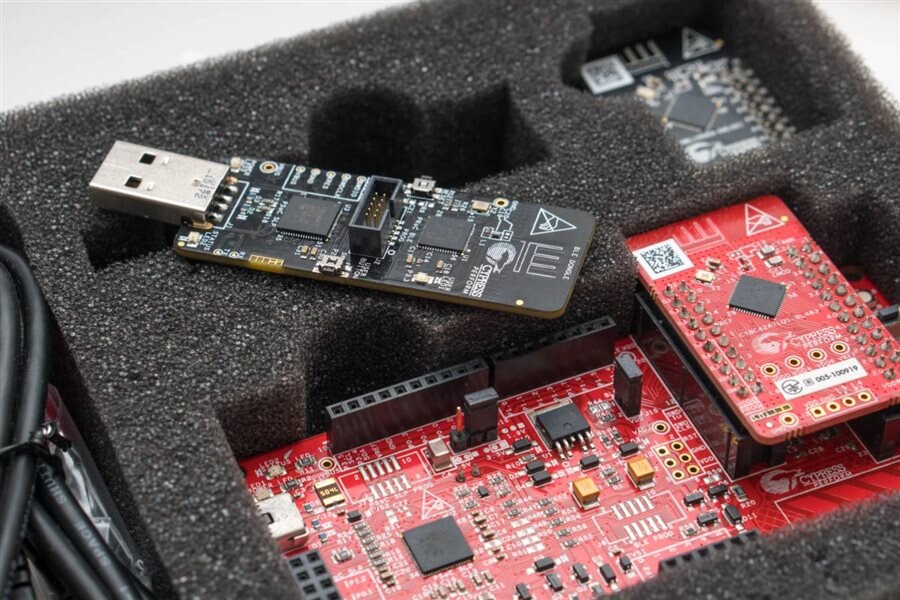

I like the Cypress Semiconductor CY8CKIT-042-BLECY8CKIT-042-BLE because it is extremely low cost (£37 from Farnell currently) and does a lot, and comes with a lot of cool hardware. There is actually a newer CY8CKIT-042-BLE-ACY8CKIT-042-BLE-A kit now that is advised, and it costs the same.
Part of the contained hardware in the kit is a nice Bluetooth LE dongle. It uses the  CY5670CY5670 chip (or CY5677 chip in the newer kit). It plugs directly into the PC and there is free software to go with it called CySmart. Once installed you can do a BLE scan and see what devices are advertising. You can click on connect, and then read the parameters, which reveals all the services information including what characteristics are supported. Then you can read or write values as desired using CySmart and see the results immediately. It is very handy!
The screenshot below shows the software in action, capturing a record of GATT information from a TI SensorTagTI SensorTag.

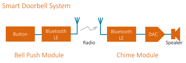

Since BLE is a standard and devices are therefore interchangeable, it becomes very attractive to use something like a Raspberry Pi for simulating your BLE product(s) until the hardware is ready. As an example, it could be possible to use one Raspberry Pi to act as a BLE Central device, and another as a BLE Peripheral device, and let them communicate with each other.
It is also possible to do more advanced things, like tunnel information from one location to another, to extend BLE to areas ordinarily not possible. If we take a doorbell scenario where there is a BLE button-push module, and a chime alert module, then I should be able to take a BLE Central device such as the button-push module, and use it with no modifications as an emergency alert button and install it at (say) an elderly relatives home, and place the BLE Peripheral device such as the chime module miles away. Provided there is a Raspberry Pi at both locations connected to the Internet, then I get the benefits of BLE (ultra-low power, fully mobile, nothing proprietary) and also the benefits of the Internet.
Or, manufacturers could sell just the button-press module, and not the chime module, to those who wish to use the Pi for audio alerts. Or sell the chime module only, for people who want a Raspberry Pi controlled and automated alerting system on a shop floor (such as for machine temperature overload alerts) and really do not need the manual bell push module. In other words, the possibilities are greatly expanded with Linux.
This blog post explores how to do this, because it is relevant to many BLE use-cases where a user may wish to expand the capabilities of their system. Code for a Linux based Peripheral, and for a Linux based Central device is described, as example building-blocks.
