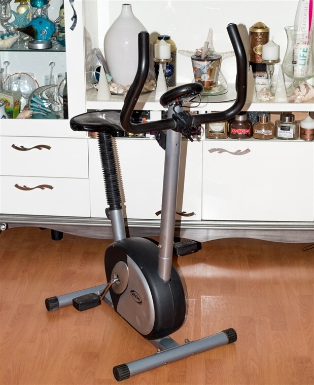

This week I want to talk about simple measurements, namely about measuring the speed and distance traveled on an exercise bike, but let me first present to you my exercise bike.
This is the most common exercise bike manufactured by Atemi, which I used for many years as a clothes hanger, and only the last three years I have used it for its intended purpose – for sports, and as a result the device suffered minor damage:
  • saddle has sagged;
  • steering has broken (it was necessary to make a new fastening);
  • locks on the pedals have broken  (without them it only got better);
  • standard bicycle computer suffered little damage  (so I now have a reason to make a new one!)
Despite of the said "cosmetic" disadvantages, the exercise bike continues to perform its main function!

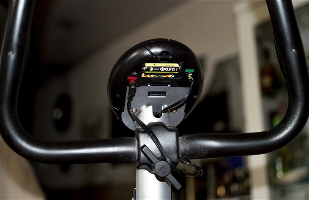

How the bicycle computer works?
Now let's focus on the bicycle computer and try to understand how it works. My bike has only two sensors connected to the computer:
  • pedal position sensor (green connector);
  • pulse sensor (red connector).

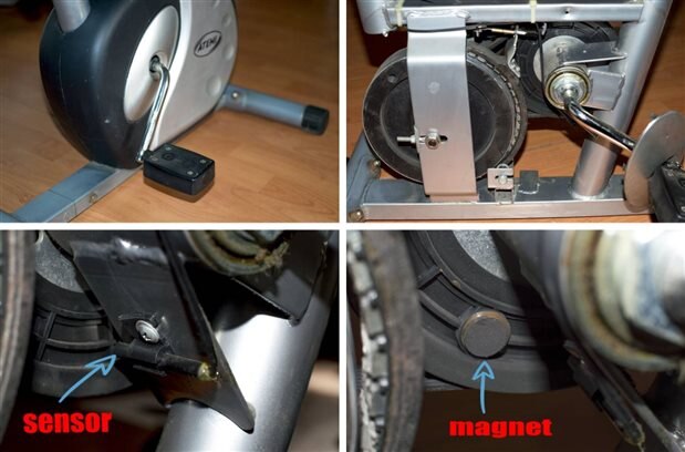

At the moment, we are most interested in the pedal position sensor. In order to better understand how it works, I dismantled the exercise bike and photographed the sensor.
It turned out that the sensor is a regular normally open reed switch, which has zero resistance when there is a sensor nearby, a magnetic field source and an infinite resistance in the absence of a magnetic field source (I was convinced of this experimentally using an ohmmeter).
There is only one magnet on the pedal assembly of the exercise bike, so the sensor generates one pulse per pedal cycle. OK, now we have the initial data to calculate the distance and speed.

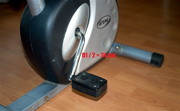

The first and simplest is the definition of distance (S1) that a person would walk by the usual step (do not run!) To do this, multiply the number of turns (N) of the pedals by the distance between the pedals (D1):
S1 = N * D1
I determined that the distance from the central axis of the pedal assembly to the axis of rotation of the pedal is 24cm, hence the distance between the pedals is 48cm.
Thus, if rider completes N = 120 turns, D1 = 0.48m, then the distance traveled by him will be:
S1 = N*D1 = 120 * 0,48m = 57,6m

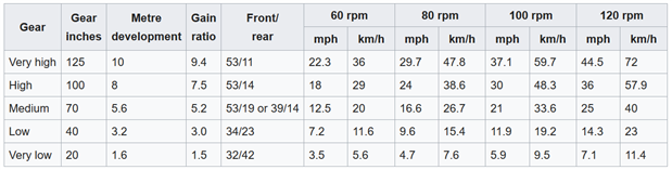

Another way to evaluate the distance traveled is to compare the parameters of an exercise bike with a real bicycle. I found the following table in Wikipedia:
According to this table, the speed is directly dependent on the [transmission]. My exercise bike has 8 tension levels and I'm currently using the 6th. Suppose this is equivalent to High Gear in the table. The table shows the speed of rotation of the pedals in rpm and the speed of the bike in km/t. For 120rpm and High Gear, the bike speed is 57.9 km/h or 0.965 km/min. Thus, making 120 turns (N) of pedals on a bicycle, we would have passed 965m (S2).
From here it is easy to determine D2 – the distance the rider passes for one turn of the pedals:
D2 = S2 / N = 965m / 120 = 8,04m
