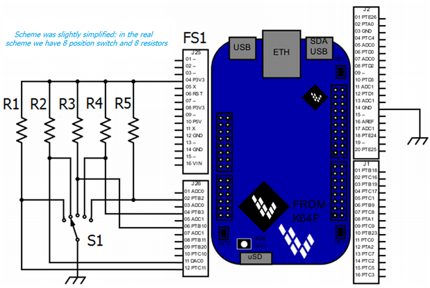

3. Determining the position of the tension knob with the help of the rotary switch. This method suggests itself – the tension knob has 8 positions (gears), why not just add one contact group to each position? The reasons for not using this method are several:
  • in the body of the exercise bike there is very little space for the installation of the rotary switch;
  • from the rotary switch will go 9 wires, which must be pulled through the entire exercise bike;
  • these 9 wires still need to be connected to the computer, so we lose a significant part of the free lines of our microcontroller;
  • rotary switches do not allow to take into account "fractional" gears (see below).

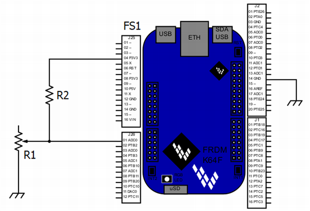

4. The drawbacks of the rotary switch method do not impact the method for selecting gears  by means of a potentiometer. When this method is implemented, the potentiometer is installed closely to the tension mechanism (rather than to the tension knob!) This achieves the maximum measurement accuracy (since in this case there is practically no backlash of the mechanism). The main drawback of the method is the complexity of its implementation, caused by the need to make changes in the design of the exercise bike.

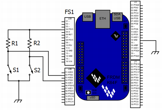

Experiment with buttons
The use of buttons is the easiest way to point to the computer in which gear the rider is riding. As already mentioned above, despite all the obvious drawbacks, this method has one important feature – no need to make changes in the design of the exercise bike. And this means that in the future I will be able to transfer my computer to a new exercise bike without any difficulties.
Below I present the code realizing the possibility of switching gears using the SW2 and SW3 buttons on my  FRDM-K64FFRDM-K64F board(in the future I will definitely transfer this program to  FRDM-KW41ZFRDM-KW41Z

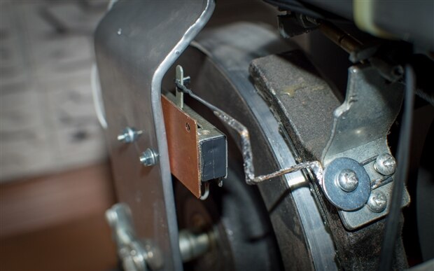

To conduct this experiment, I specifically asked my colleagues to pick up for me some good potentiometer. They offered me an USSR slider potentiometer [SP3-23A]. This potentiometer has a fairly large size, which simplifies its installation on exercise bike. I secured it by screw connection through a foil-shaped PCB. The rod between the potentiometer stick and the tension mechanism of my exercise bike was made from two large clerical clips welded together:
To carry out the experiment it is necessary to determine the voltage U_adc(G) at the input of the ADC using the formula:
U_adc (G) = R1 (L) / (R1 (L) + R2) * U2
For this we have the following data:
  • resistance of resistor R2 = 20 kOhm;
  • voltage at the input of circuit U2 = 3.3 V;
  • on the first gear (G = 1), the resistance of potentiometer R1(G1) = 2.72 kOhm;
  • on the eight gear (G = 8), the resistance of potentiometer R1 (G8) = 9.96 kOhm.
U_adc(G1) = 2.72 / (2.72+20.00) * 3.3 = 0.32 V
U_adc(G8) = 9.96 / (9.96+20.00) * 3.3 = 1.10 V
We get the voltage difference U_adc(G8) – U_adc(G1) of the order of 0.78 V, which corresponds to ~ 22% of the ADC measurement range at a reference voltage level of 3.3 V or ~ 60% at a reference voltage level of 1.2 V.
Now, knowing that our microcontroller has a 16-bit ADC with a reference voltage of 1.2 V, we can determine gear (G) from the ADC value (V). Without going into the details of calculations, I will give the formula I obtained:
G = 0.002629 * V – 1.871

Today I managed to execute one more item from my plan Maximum – to determine the “gear” in which the rider is riding. The only thing I would like to work on is the rod of the potentiometer. I made it from clerical paper clips and now their stiffness seems to me insufficient. Perhaps in the future I will make it from a welding electrode.
