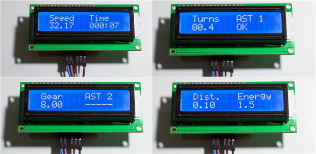

The indication thread causes additional functions that are designed to form an information on LCD display. Below are listings of these functions.

// get the 'name' of the 'mode'
const char *mode_name(char i)
    switch
        case 0:    return " Speed  ";
        case 1:    return " Turns  ";
        case 2:    return " Gear   ";
        case 3:    return " Dist.  ";
        case 4:    return " Energy ";
        case 5:    return " Time   ";
        case 6:    return " AST 1  ";
        case 7:    return " AST 2  ";
        case 8:    return " AST 3  ";
    return "ERROR   ";
Photos of the computer in different modes of operation are given below. In total, we now have 81 options for composing information on the screen!
