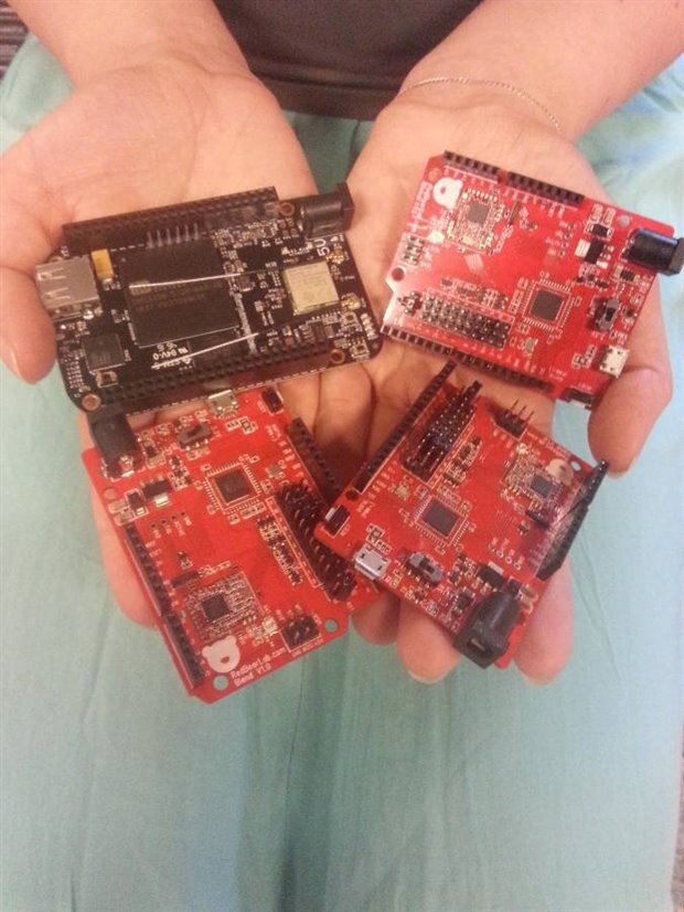

New boards
I used the Element14 shopping cart to get two more Blend boards, a Beagle Bone Wireless and some tools and components that will power up my workshop to make my life easier when working on this project. I am now flooded with boards:
I already elaborated on the unlucky fact of the Blend's developers discontinuing the series in my previous post. Fortunately, those still are perfectly functional Arduino Leonardos. And to raise the spirits, I started playing with the Beagle Board, which is a very powerful and interesting alternative to Raspberry Pi. The most easily noticeable differences are less USB ports on the Beagle, and far more GPIOs. It ships with a full-blown Debian already on board and works out of the box - it requires no SD card and all it takes is plugging it to your PC with the included micro USB cable. The system is already there on the built-in Flash memory and the board creates an Ethernet-over-USB connection that you can use to check out a few flashy features it presents on its web interface (including a web-based IDE called Cloud9, which I might use one day for another project) or simply to SSH to it in order to give it your WiFi credentials, which I did. I then plugged it out and powered it over a wall-wart, and it has been sitting in its corner for about a week, kindly doing its work when asked with very few issues. It's also worth noting that the whole project is open source, which results in interesting related products being released, like the robotics-friendly Beagle Bone Blue or the Beagle Core intended for industrial applications. My intention is to make the Beagle Bone my command center for this project; it will run OpenCV for identifying the LED strips and will be the master device for all the BLE connections. Probably I will put more responsibilites on it but decisions related to this will be made later.

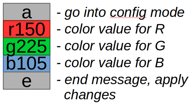

Early draft of LED Animator's communication protocol
The "protocol" will be in fact just a bunch of ASCII bytes representing commands and values. How elaborate it will get depends on how much time I have to develop bonus features, but the minimum is a command to enter config mode and change animation sequence, as well as an RGB parameter to pass the Animators their palettes. The protocol follows an extremely simple "command+parameter+end message" syntax, using single chars to denote command and parameter types. An example follows:
More commands are planned, and I am also considering adding more parameters, e.g. brightness and animation speed.
