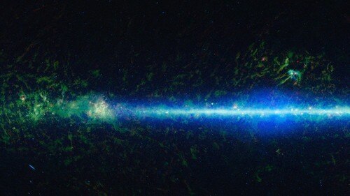

For testing the image manipulation algorithms, we're also going to need some actual imagery. While browsing NASA public domain archives, I found a very nice image of space, with a horizontal strip of colored light going right through the middle:
Image source: NASA
This will be a nice, albeit a bit overly spectacular, substitute for my humble LED lighting system for a while. Let's see what we can get from it. Feel encouraged to use your own imagery, or at least a different pic from the Web - the real draw of computer vision is that you can process _anything_, and it's best experienced on data different from what your tutorial shows you.

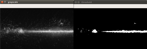

Enough talk, let's go and make something in Python. The first feature of OpenCV we're going to try is called thresholding, and is probably the simplest method of removing excess visual i   nformation from the input image. The idea is to compare each pixel against the titular threshold, changing the pixels above it to pure white and all others to pure black. It is extremely useful as one of the steps of image transformation before the actual analysis.
#import the OpenCV module
import cv2
#read the image file
image = cv2.imread('nasa.jpg')
#convert the image to grayscale
gray = cv2.cvtColor(image, cv2.COLOR_BGR2GRAY)
#perform the actual thresholding
ret, thres = cv2.threshold(gray, 127, 255, cv2.THRESH_BINARY)
#show the original image, the BW version and the post-thresholding version
cv2.imshow('colour', image)
cv2.imshow('grayscale', gray)
cv2.imshow('threshold', thres)
#kill the windows if any key is pressed
cv2.waitKey(0)
cv2.destroyAllWindows()
The code is commented, but worth some further explanation. At the very beginning, our test image is read into an object - an array which you can actually print() to get a flood of numbers describing each pixel. Any processing of the image will create a new object for us to work on - we usually don't care about the actual numbers but it's good to know. Like in most OpenCV applications, image transformation has multiple stages - in this case we use two. First comes the cvtColor() method with the cv2.COLOR_BGR2GRAY parameter, used to turn the image to grayscale - a very common approach as it significantly reduces the amount of computation required further down the line when we don't need the actual colour information. The threshold() method comes next, and it takes the following arguments: source image, threshold value, value to give to the pixel when above the threshold, and the thresholding method - there are plenty to choose from but THRESH_BINARY works for us. The "ret" value that is the first returned value is not interesting to us at the moment, and we put our processed pixels into the "thres" object. Finally, we print the images to screen on the BBW. Here we are with our first processed images:
Not a lot, but definitely a good start. We have the interesting feature (the strip of bright light) partially highlighted and in the next few step we'll be trying to improve on it. At this point it's worth noting that OpenCV accepts video clips and feeds (camera input, screen capture etc.) just as well as static imagery, converting all video to individual frames. I'm not using this in my project so I haven't travelled down that avenue, but here's a link to the docs that explains how to use this.

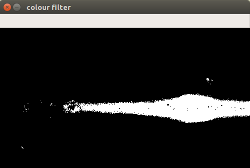

Instead of turning the image to grayscale and then thresholding, we can try colour filtering to bridge the gap in the strip of light:
hsv = cv2.cvtColor(image, cv2.COLOR_BGR2HSV)
filter = cv2.inRange(hsv, np.array([70,40,150]), np.array([140,255,255]))
cv2.imshow('colour filter',filter)
The above lines should be inserted below line 11 in the code sample, and numpy module importation must be added on top:
import numpy as np
What happens here is basically a range of colours gets selected thanks to the magic of the HSV colour space. The parameters of the inRange() method are the image converted to HSV and two arrays representing HSV colours. HSV is far better for colour filtering than RGB, as it approaches colours like humans do - taking into account its Hue (actual colour), Saturation (between dull grays and rich colours) and Value (dark-light), which allows us to select a colour range based on these criteria rather than a sum of its colour coefficients, which may seem difficult to grasp at first as most of us are more familiar with RGB, but a quick look at the HSV cone should make it all clearer:

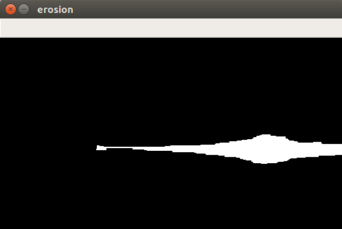

Back to our image manipulation. The result of filtering out all non-blue colour is a much thicker, but more importantly, also a longer line:
It's still far from satisfactory though. Part of the fun in OpenCV is being able to juggle the algorithms until the images begin to make sense - we can and should play with different morphing methods and their parameters, and there is an abundance to choose from. Here's our image after I used the Closing algorithm to literally close the gaps in the white shape and performed two iterations of Erosion to make the blob thinner:
The code used to create this effect is as follows:
#create a kernel for Closing and Erosion - an 8x8 matrix that will be used to 'scan' our image  for holes and edges
kernel = np.ones((8,8),np.uint8)
#apply both algorithms sequentially
closing = cv2.morphologyEx(filter, cv2.MORPH_CLOSE, kernel)
erosion = cv2.erode(closing,kernel,iterations = 2)

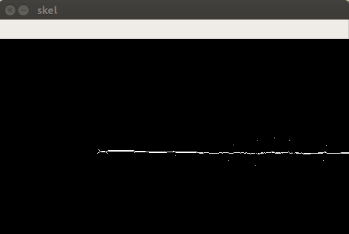

Better still, we can try to skeletonize the above image, getting an almost-perfect line:
The code is getting complex when we add the skeletonization code to all else:
size = np.size(erosion)
skel = np.zeros(erosion.shape,np.uint8)
element = cv2.getStructuringElement(cv2.MORPH_CROSS,(3,3))
done = False
while( not done):
    eroded = cv2.erode(erosion,element)
    temp = cv2.dilate(eroded,element)
    temp = cv2.subtract(erosion,temp)
    skel = cv2.bitwise_or(skel,temp)
    erosion = eroded.copy()
    zeros = size - cv2.countNonZero(erosion)
    if zeros==size:
        done = True
cv2.imshow('skel',skel)

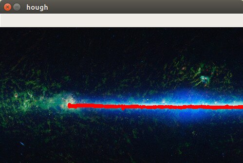

And finally after one more iteration of Closing we try the nitty-gritty - Hough Lines Probabilistic Transform - to map our line:
The code used to generate the above looks like this:
#perform one more iteration of Closing
closing = cv2.morphologyEx(skel, cv2.MORPH_CLOSE, kernel)
#use Probabilistic Hough Line Transform - with those very 'tolerant' settings, it actually just maps points and short lines in the image
HoughThres = 0
minLineLength = 1
maxLineGap = 1
lines = cv2.HoughLinesP(closing,1,np.pi/180,HoughThres,minLineLength,maxLineGap)
#draw the lines and points onto our original image
for x in range(0, len(lines)):
    for x1,y1,x2,y2 in lines[x]:
        cv2.line(image,(x1,y1),(x2,y2),(0,0,255),5)
cv2.imshow('hough',image)
The line detection is almost perfect. Why almost? We'll explore the details in my next blog post, but the parameters of the Hough Transform were chosen by trial and error, and what we got here is actually a crowd of points and very short lines, which I could use but I'd rather have a single straight line.

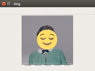

Bonus
As an unrelated takeaway and a small teaser of OpenCV's capabilities, here's a super-quick Python script that overlays emoji on people's faces. It took 15 minutes to write (for somebody who's first used OpenCV two weeks ago), uses a Haar Cascade, which seems to be the easiest face detection method, and this StackOverflow thread helped solved alpha channel (transparency) problems. Check out the results and the code:
Image sources [1] [2]
import numpy as np
import cv2
#cascade source https://raw.githubusercontent.com/opencv/opencv/master/data/haarcascades/haarcascade_frontalface_default.xml
face_cascade = cv2.CascadeClassifier('haarcascade_frontalface_default.xml')
img = cv2.imread('woman.png')
clown = cv2.imread('emoji.png')
gray = cv2.cvtColor(img, cv2.COLOR_BGR2GRAY)
faces = face_cascade.detectMultiScale(gray, 1.3, 5)
x_offset=faces[0][1]-10
y_offset=faces[0][2]
y1, y2 = y_offset, y_offset + clown.shape[0]
x1, x2 = x_offset, x_offset + clown.shape[1]
alpha_s = clown[:, :, 2] / 255.0
alpha_l = 1.0 - alpha_s
for c in range(0, 3):
    img[y1:y2, x1:x2, c] = (alpha_s * clown[:, :, c] +
                              alpha_l * img[y1:y2, x1:x2, c])
cv2.imshow('img',img)
cv2.waitKey(0)
