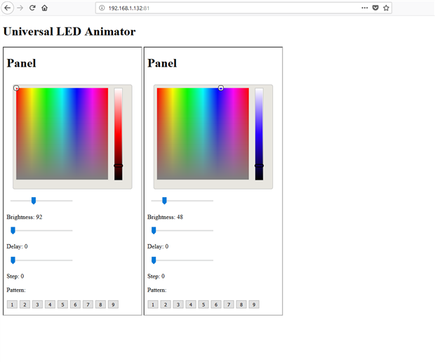

More JS, and HTML too
Having embedded ColorJoe in my web interface, I needed to think about how do I handle a multitude of devices from that single website. Having very little knowledge of modern Web development, I decided to use IFrames. Creating an IFrame dynamically for each connected animator (still a TODO), I read their IDs and put them in every GET request. This way, a request for brightness change gets one more field:
xhttp.open("GET", "/set_brightness?brightness=" + slider.value+"&id=" + window.name, true);
Window (IFrame) names are incremental IDs that will be generated dynamically in the future. At the moment I statically create two IFrames for testing, and have moved my entire pattern-related interface there, resulting in a new file, panel.html:

As you can see, I have also changed the buttons to run a simple JS script that also creates a GET request with an ID and a mode number. The index.html now only serves a scaffolding of IFrames:

Some serious Flask code
Ok, not so serious perhaps. Most serious I've ever written anyway. What used to be a few lines of Python serving a few buttons and sliders has grown considerably, and parsing two-parameter GET requests (consisting of an animator ID and a animation parameter to be set) has been generalised in a single method:

This code, and the HTML layout and style, is still a work in progress, but this update shows the direction I'm heading. I'd love to post some videos but two of my three Blends stopped responding very recently and at the time of writing this post I'm still trying to solve the problem.
