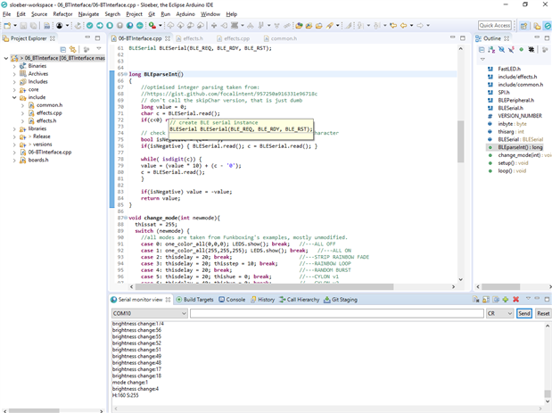

My work environment
The Blend/Arduino side of this project has been developed using three Hero boards, RedBear Blends, with ATMega32U4's and Nordic's nRF8001 BLE modules. Each of them is basically an Arduino Leonardo with a BLE radio module. Code was written using the wonderful Sloeber IDE and (very messy) version control was maintaned with EGit. I seriously recommend Sloeber as the way to go with anything bigger than the smallest Arduino projects. I'm just amazed by how nice it can be to work with MCUs in this environment, and I think the only things I miss from Arduino IDE are GUI colours and loading times.

The library I'm using here is Sandeep Mistry's BLEPeripheral. I put it in the code to replace the HC-05 interface that was there before, as the Blend utilises the nRF8001 and in the future I either want to use that module on a separate PCB, wired to the Arduino, or ditch it entirely and use a different BLE module. Anyway, BLEPeripheral works great and offers a lot more features than the UART service that I'm using in this project - taking it up was very educational and what I learned will facilitate some other projects I've never thought I could finish.
The BLE command parser looks for every possible command-encoding byte, and there are not many: one each for mode change, setting up delay, step (not used in this release), hue and saturation (only together, i.e. you can't change saturation by itself), and one command to output the library version number to UART, useful for debugging your connections. There is no ParseInt() method in the library, so I used an optimised version of the default Arduino one (click the link, it's very educational). The protocol is obviously expandable - a nice-to-have feature that first comes to mind is adding a more colour picking options for multi-colour effects, like three pixels bouncing up and down, each with a customizable colour - currently only one is customizable.
