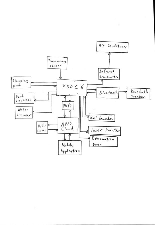

In this blog post, I will give a rough idea of what I'm going to do with my project.
Below is the block diagram of my project:
Block diagramimage

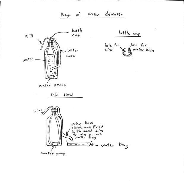

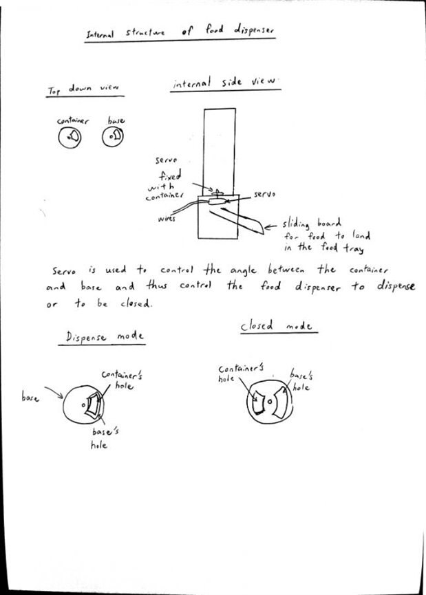

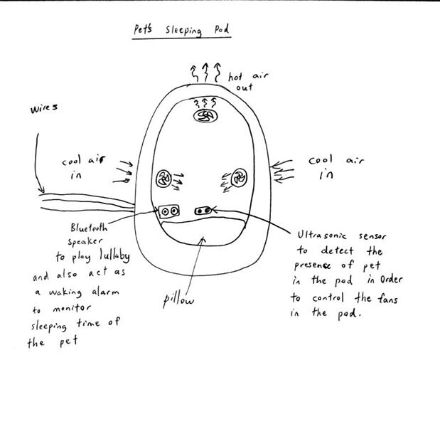

The designs of the peripherals such as food dispenser, water dispenser, and sleeping pod are as below:
Food dispenser
Water dispenser
Sleeping pod

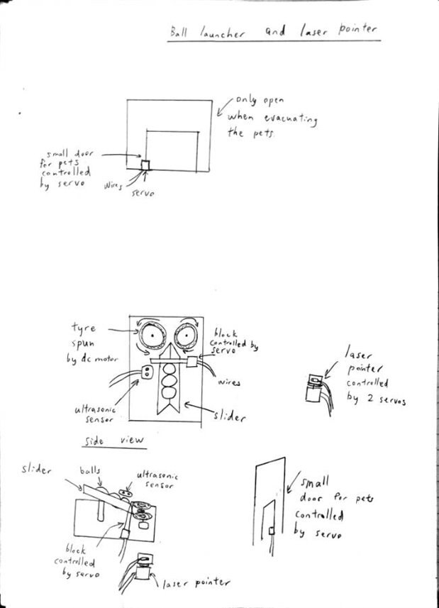

Ball launcher, laser pointer and evacuation door

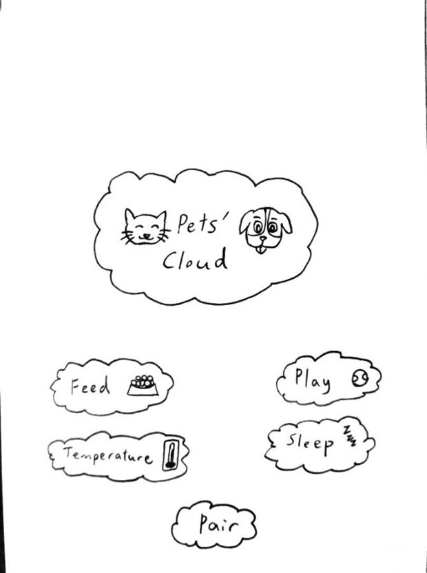

The user will have access to the whole system through a custom design mobile application which is connected to the AWS IoT Cloud.

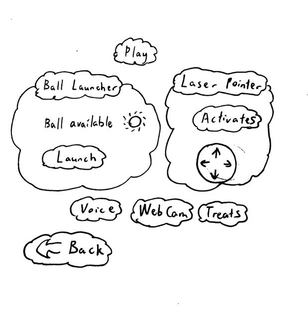

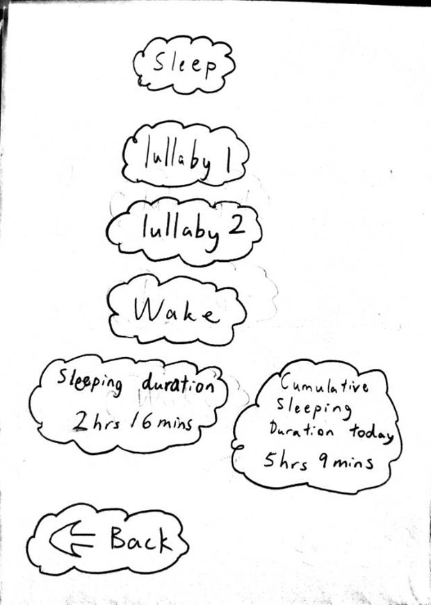

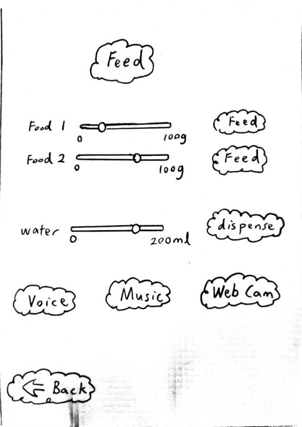

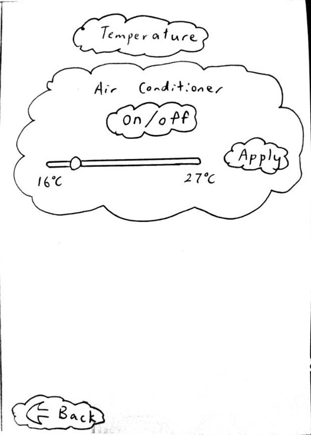

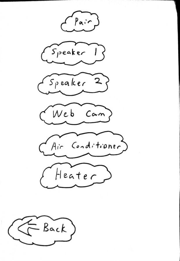

Below is the early-stage design of the user interface of the mobile application:
user interface
