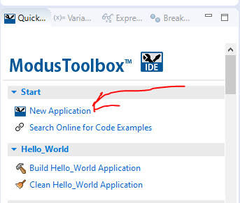

I then started to test out the example code in the ModusToolbox 2.1.

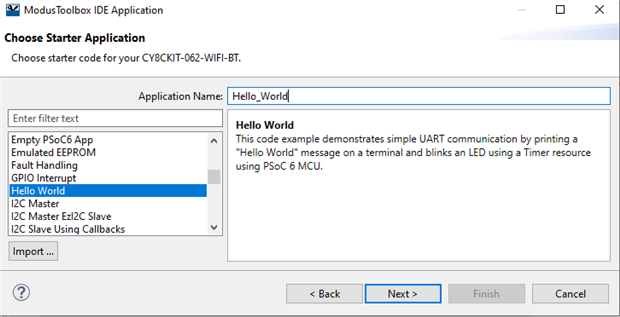

Clicking New Application at the bottom left corner.

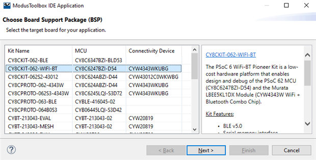

Choosing the Board Support Package(BSP):
In my case, I chose the BSP for CY8CKIT-062-WIFI-BT and clicked Next>.
Choosing a Starter Application:
There are various of Starter Application to assist a beginner like me. To get familiarize with the ModusToolbox 2.1, I chose a Hello World starter application.
The application name can be changed in the Application Name column if wished. In my case, I will just leave it as it be and click the Next> button and then Finish button to generate the application.

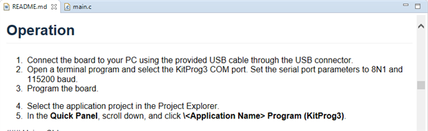

When the application is created completely, a README.md file that explains how the application works will show up.
Scroll down to the Operation part and follow the instruction to get the application works.

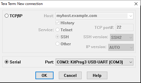

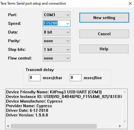

This application requires us to have a terminal program. In my case, I used Tera Term which can be downloaded here: teraterm-4.105.exe
After downloading and launching Tera Term, in the serial port section, choose KitProg3 and click OK button.
From the navigating tab, click Setup and choose Serial Port... , a Tera Term: Serial port setup and connection tab will pop up.
Set the speed to 115200, which is the baud rate of the PSoC 6 WiFi-BT Pioneer Kit and click New setting button.

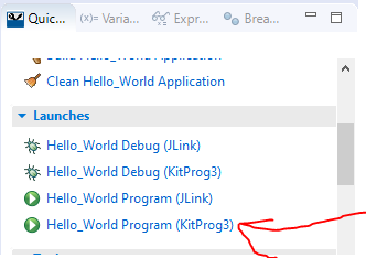

Back to the ModusToolbox 2.1, in the Quick Panel, scroll to the Launches tab and click <application name> Program (KitProg 3) button to program and run the application.

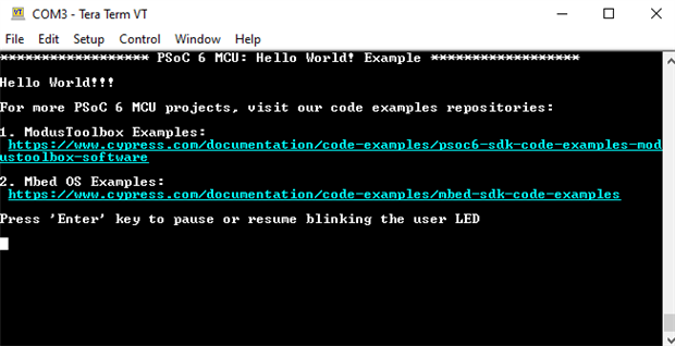

The Tera Term will print these lines once the building and running process complete.
Hello World testing on PSoC6

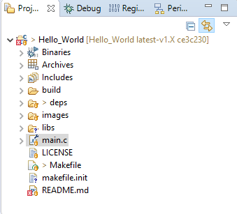

After testing the Hello_World application on PSoC6, it is good to look through the code to get familiarize with the functions which can be used to initialize the pin and peripherals of PSoC6.
In the Project Explorer, under Hello_World, there is a main.c file. Opening the main.c allows us to look through the code for the application.
