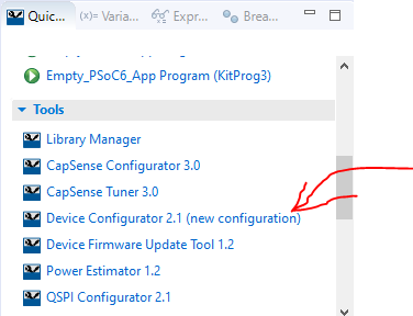

Following the guide, I opened up Device Configurator in ModusToolbox. Device Configurator is a Tool you can find in ModusToolbox to help you configure yr our pins, peripherals, clock frequency, and so on.
The Device Configurator can be found in the Quick Panel > Tools.

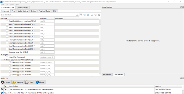

Below are some views in the Device Configurator:
You can configure the peripherals such as timer and peripheral-clocks in the Device Configurator.

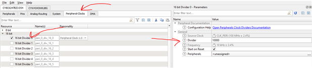

First, I have clicked to the Peripheral-Clock tab to configure the peripheral clock.
I then chose a 16-bit divider for my peripheral clock and set the divider value to 10000 to get a 10kHz clock.

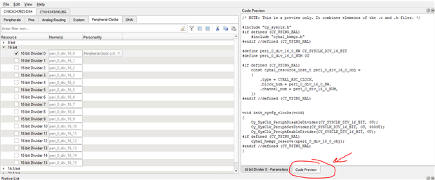

At the right bottom, you can click to Code Preview tab to see the code generated according to your parameter setting. You can look through it and copy it for further modification to implement in different type of cases.

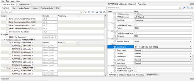

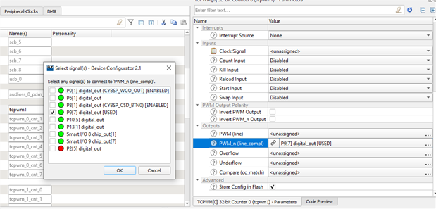

I then go the Peripheral tab and chose to activate the TCPWM[0] 32-bit Counter 0 and named it tcpwm1. At the right hand side, you can adjust the parameters of the tcpwm1. In my case, I have set the period to 10000 and compare value to 5000. Since my peripheral clock is 10kHz, setting 10k count for my period and 5k count compare value will give me a 1Hz clock cycle and a 50% duty cycle. I have also assign the 16-bit Divider 0 clk that I have configure previously as the input Clock Signal.

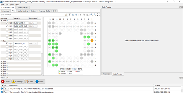

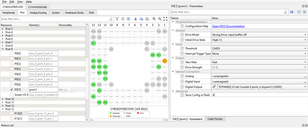

I then scroll down to the Output section, and assign the pin for PWM_n(line_compl). You can look through the datasheet of your board and choose the pin that has the location that is most favorable for you. I have chosen the P9[7] in this case. Similarly, you can look through the code in the Code Preview if you wish so.
When I click to the Pins tab, I have notice that ModusToolbox have already setup the P9[7] for me, all I have to do is just give a name to the pin. You can ignore this step as ModusToolbox will use the default name for it and the application will still work anyway even though you don't name it.

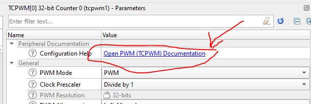

The relevant functions required to interact with the tcpwm can be found through the Open PWM(TCPWM) Documentation link found in the Device Configurator.
In my case, I included the "cycfg.h" header file and initialize the cycfg using the  added the 3 lines code below in the main.c and run it on the PSoC6.
