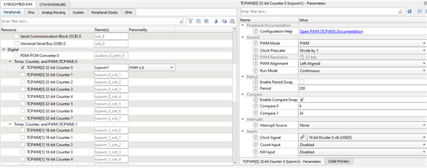

I start by using the application I have create during the last blog post. I leave the tcpwm1 and the clock divider untouched.

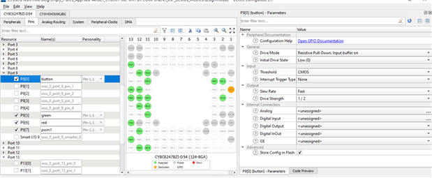

Enable a pin and named it button. Set its Drive Mode to Resistive Pull-Down. input buffer on. Resistive Pull-Down means that the pin will discharge to logic low when the pin is not connected to a logic high source. This can eliminate the undefined state when the pin is not connected. Meanwhile, input buffer on allow the pin to work as an input pin.

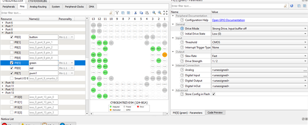

I have also enabled another 2 pins and named them green and red, which they will be connected to a green and a red LED later on. I chose Strong Drive. input buffer off which will let the pin transition faster and act as an output pin.

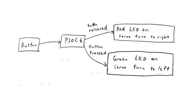

Initially, I have meant to program the code to have the following function:
Block diagram of servo and LED controller.
The LEDs work find just like I want them to, however, the servo is behaving weird.
